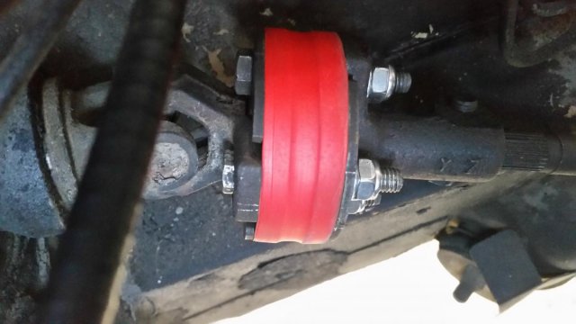

Natez Posted July 15, 2015 Author Share Posted July 15, 2015 Replace the steering coupler. One of the bolts stripped. Those bolts are M8×1.25 with nylon lockouts + split lock washer. Quote Link to comment Share on other sites More sharing options...
