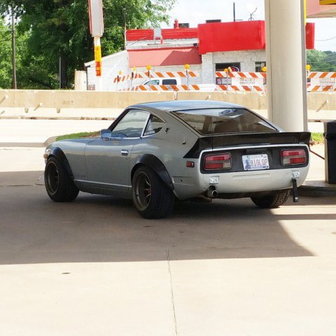

seventyfour Posted August 1, 2015 Share Posted August 1, 2015 Hey guys. I have a 73 240z that I purchased on cut springs. I have done a lot of other things to her since then including my flare/wheel setup as seen in the picture attached below. I ran out of money until recently (sold my former project car) and I'm ready to rectify the situation with the z's suspension. Personally, I think it sits absolutely perfect. The issue is that the stock cut springs are far too soft and my tires rub over decent bumps and I can't put two people in the car AT ALL. I want a spring/shock combo that is much stiffer than stock but that won't make my car sit like a monster truck. Most lowering springs don't look too stiff, and they only advertise a 1" drop. Am I doomed to spending 1200+ dollars on coilovers, even on a car that will never see a racetrack? Thanks for any help. Quote Link to comment Share on other sites More sharing options...
