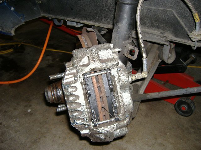

Kamaka Z Posted August 4, 2015 Share Posted August 4, 2015 I am installing the toyota 4 piston caliper upgrade on my 77 280z. can i use braided stainless lines from the hard line to the caliper? Quote Link to comment Share on other sites More sharing options...
Miles Posted August 4, 2015 Share Posted August 4, 2015 Yes. Several options available. My solution was to use a -3 SS line with a 10mm x 1.0mm inverted flare on the hard line end and a -3 to 10mm x 1.0 inverted flare adapter on the brake end. See picture. Note adapter in brake caliper and hard line connection. Quote Link to comment Share on other sites More sharing options...
