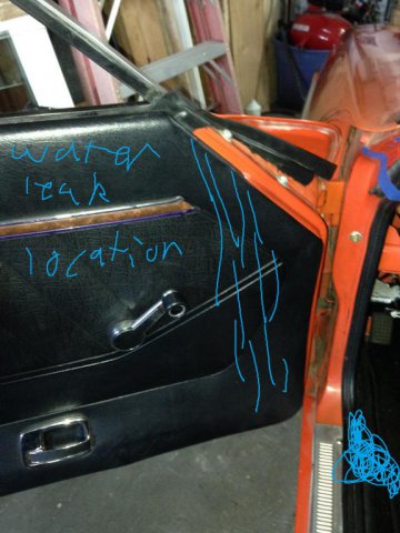

A water leak is present on both the drivers and passenger doors, the water can be seen running down the front side of the door panel onto the carpet(see pic). The leak is coming from the doors and is not from the front windshield, it appears to be coming from the area where the door frame seal and the door to fender seal meet.

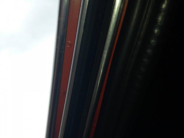

-chrome window run channel had a slight gap of fitment to the door frame seal at the top, and wasnt much pressure on the seal(see pictures)

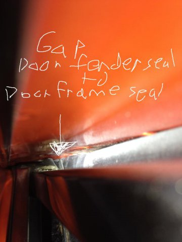

-door frame seal to the door to fender seal had a slight gap that seemed like water could run through.(see picture)

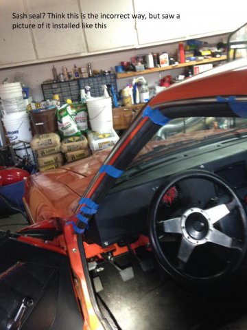

The kit came with a 280z sash seal, which is not indicated for my year, but may possibly fix my issue(hell cant hurt).
-is there a difference between the early 260z chrome window run channel vs the 75-78 280z chrome window run channel?
-Does the sash seal attach to the top of the chrome window run channel, or does it attach to the body(I have been told both)?
-what is the correct direction and placement of the sash seal?
