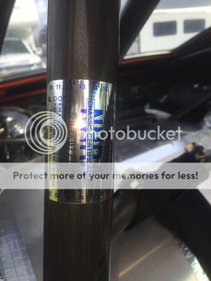

nathaninwa Posted March 12, 2016 Author Share Posted March 12, 2016 All prepped and ready to chassis inspection tomorrow Quote Link to comment Share on other sites More sharing options...
nathaninwa Posted March 12, 2016 Author Share Posted March 12, 2016 Got my cert today Went easier than I was stressing about! I thought for sure they would inspect my back half connections and my subframe connectors They really just checked for complete welds at the roof line and good visual Inspection along with ultrasounding all the bars. They commented more than once that the cage was really nice and the welding was superb. I understood what they meant after looking at other cars! Quote Link to comment Share on other sites More sharing options...

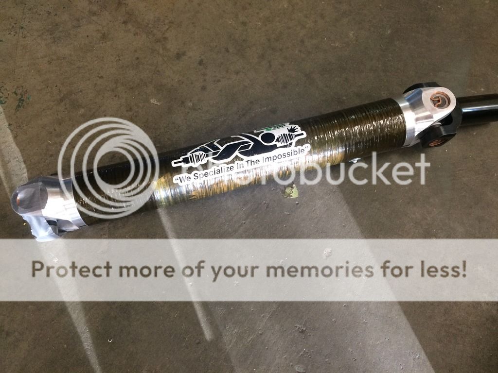

nathaninwa Posted March 20, 2016 Author Share Posted March 20, 2016 Quote Link to comment Share on other sites More sharing options...

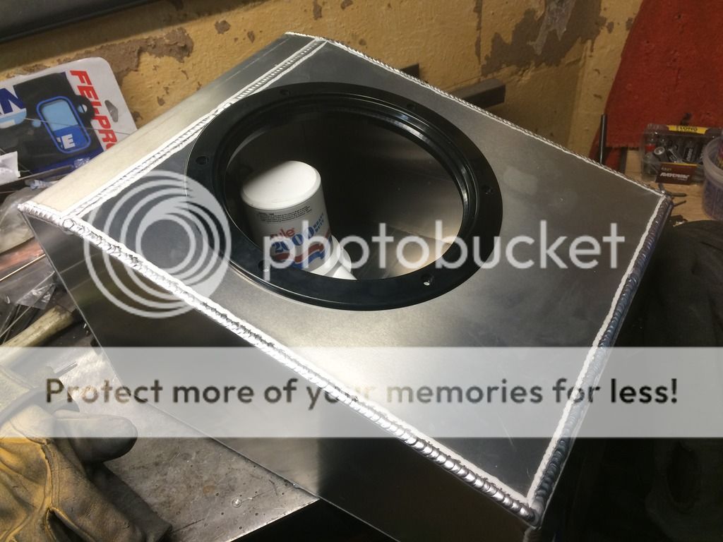

nathaninwa Posted March 20, 2016 Author Share Posted March 20, 2016 And have the ice box welded together. I'll work on mounting and fittings tomorrow I think Quote Link to comment Share on other sites More sharing options...

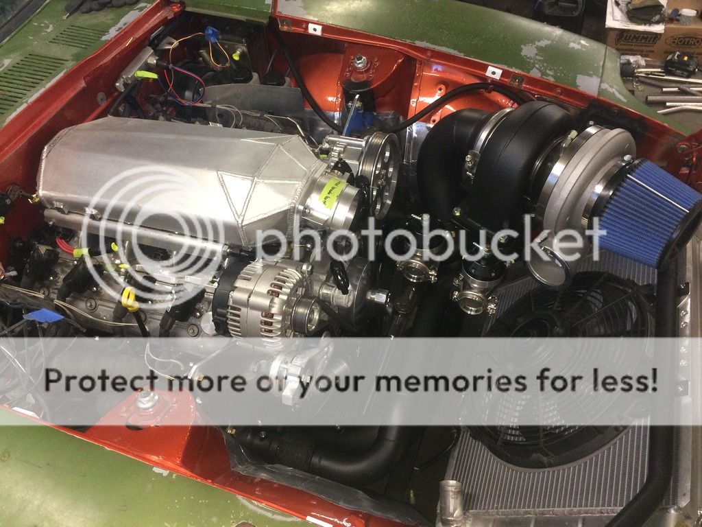

nathaninwa Posted March 27, 2016 Author Share Posted March 27, 2016 Mechanically this car is done. The wiring is getting a little upgraded now. Should be running be next weekend Quote Link to comment Share on other sites More sharing options...

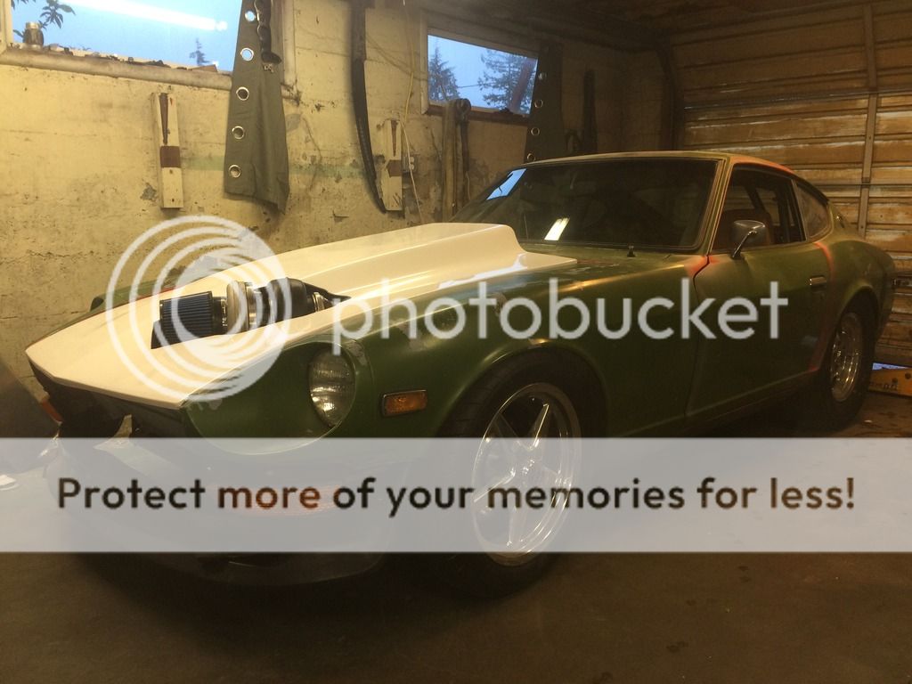

trackzpeed Posted March 28, 2016 Share Posted March 28, 2016 Nice ride.... not much of a sleeper with turbo parts sticking out of the hood. Amazing fit and finish, cant wait to see her run. Quote Link to comment Share on other sites More sharing options...
1969honda Posted March 28, 2016 Share Posted March 28, 2016 ^^^^it's just a little turbo Datsun.... Quote Link to comment Share on other sites More sharing options...
nathaninwa Posted March 28, 2016 Author Share Posted March 28, 2016 I don't mind the turbo sticking out the hood a little on this car. My other driver is a total sleeper and have surprised quite a few mustangs and vettes with it. This one was all about the drag race, and me wanting specific things in specific spots, and it worked out the best to poke the turbo out. It seems that my engine bay filled up fast compared to other builds Ive seen Quote Link to comment Share on other sites More sharing options...

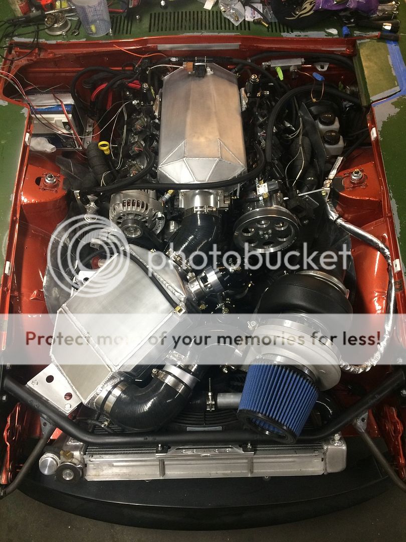

nathaninwa Posted March 30, 2016 Author Share Posted March 30, 2016 Ooh lala Quote Link to comment Share on other sites More sharing options...
nathaninwa Posted April 3, 2016 Author Share Posted April 3, 2016 Car fired up tonight Tune is off for sure from the all motor tune it had! Got about 1 min run time right now, going to change the oil tomorrow and get it up to temp and load the motor on the trans brake a little I'll then change the oil out for the joe Gibbs I have for it and work on the tune more Quote Link to comment Share on other sites More sharing options...

nathaninwa Posted April 3, 2016 Author Share Posted April 3, 2016 Had some rewiring todo this morning. Seems the boost solenoid and internal pull-up Hall effect sensor I use for front vss was keeping the relay panel on. So moved to the ignition switch and all is good now. Working on getting th oil changed and a wee bit more tranny fluid in it Quote Link to comment Share on other sites More sharing options...

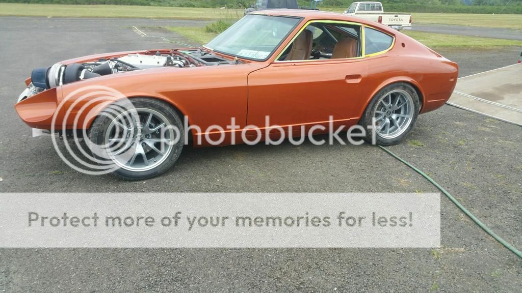

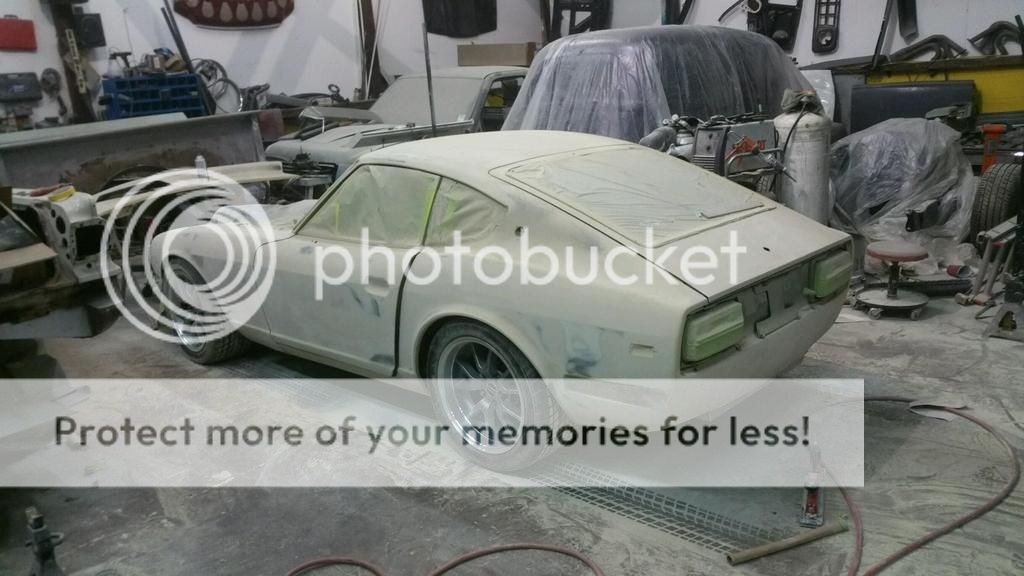

nathaninwa Posted May 13, 2016 Author Share Posted May 13, 2016 The sneak peak Quote Link to comment Share on other sites More sharing options...

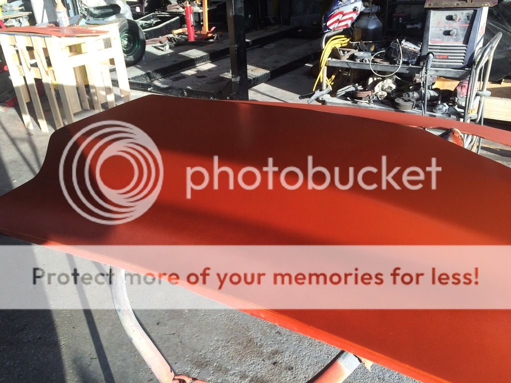

nathaninwa Posted May 24, 2016 Author Share Posted May 24, 2016 (edited) Sneak peak of the color Edited May 24, 2016 by nathaninwa Quote Link to comment Share on other sites More sharing options...

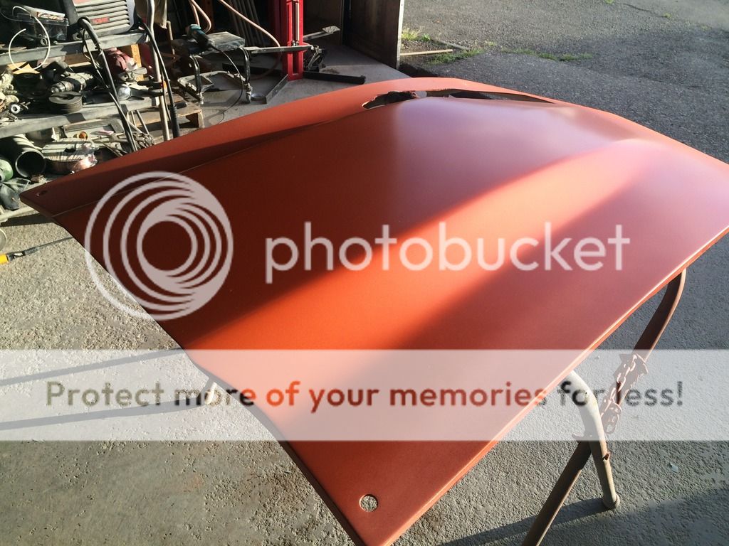

nathaninwa Posted May 27, 2016 Author Share Posted May 27, 2016 Out of the paint booth ready for a little cut and rub Quote Link to comment Share on other sites More sharing options...
