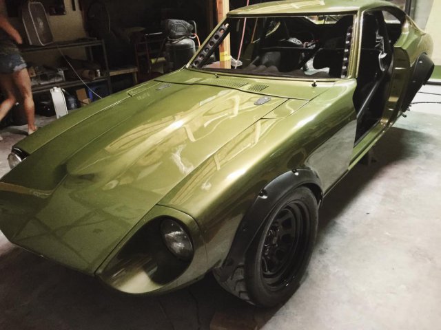

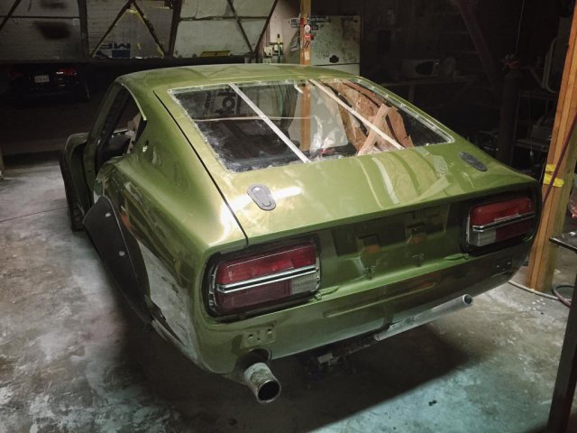

fyanrudger Posted October 1, 2015 Share Posted October 1, 2015 Agreed. Just pointing out that if care is taken beforehand, most of the bodywork could be sorted before epoxy and all the glaze filler steps can be avoided after poly primer surfacer. Just did the following with my car: Down to metal. Bodywork. Epoxy - guidecoat - three small filler spots. Poly primer surfacer - guidecoat - 400 wet sand. Off to a professional shop for sealer/base/clear. Quote Link to comment Share on other sites More sharing options...
