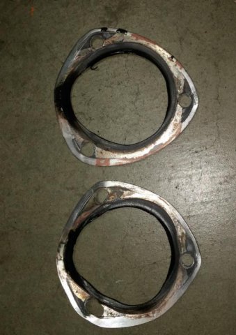

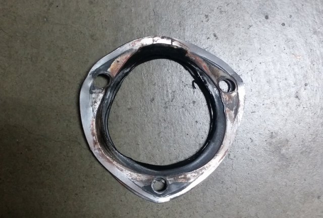

ktm Posted November 28, 2015 Share Posted November 28, 2015 My LS1 swap likes to chew through the header collector gaskets. The first gasket that was installed at the exhaust shop was a typical composite gasket. It lasted all of 1000 miles before burning through. I then installed a solid aluminum gasket on both collectors and they only lasted 6000 miles. The pictures below show the gaskets after I took them off the car. The second image shows the two gaskets overlaying each other and the distortion is identical, eventhough they "failed" 180 degrees apart. In other words, one gasket failed facing the radiator core and the other facing the rear of the car. Does anyone else have this issue? It's not hard to change them out, only a PITA due to the tight confines and the bolts siezing due to the heat. Quote Link to comment Share on other sites More sharing options...
