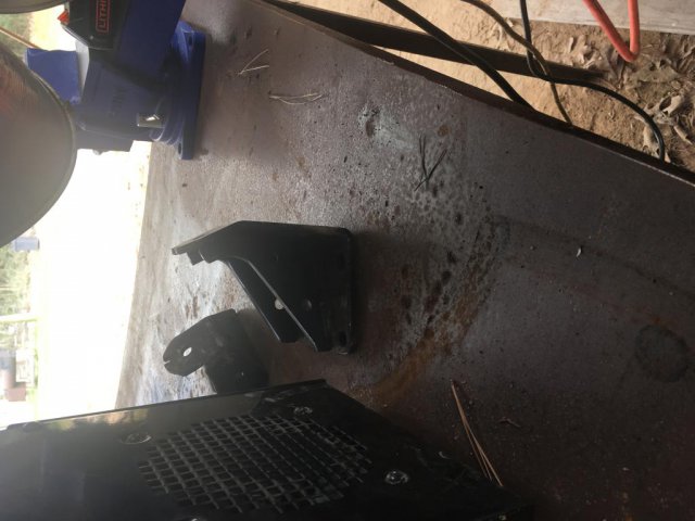

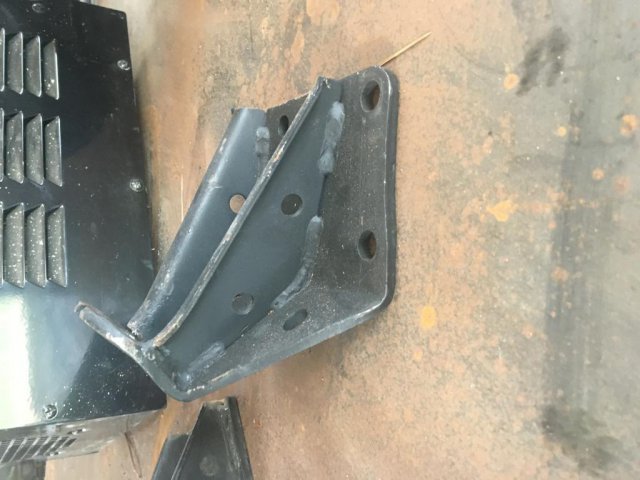

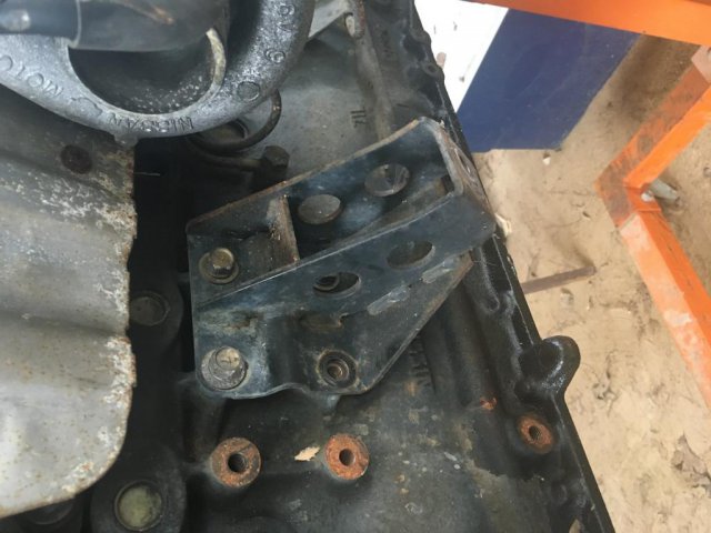

boosted280 Posted February 13, 2016 Author Share Posted February 13, 2016 Those mounts appear to be at a 90 degree angle. The other guy I seen pics of with a rb20 in his s130 had the mounts with like 45 angles. That's what makes me question it. Quote Link to comment Share on other sites More sharing options...
winstonusmc Posted February 13, 2016 Share Posted February 13, 2016 Take a picture of your mounts Quote Link to comment Share on other sites More sharing options...
boosted280 Posted February 14, 2016 Author Share Posted February 14, 2016 The one one the motor is what came with it. And the black ones are the ones I ordered. You can see the one that was modified to match. Quote Link to comment Share on other sites More sharing options...
winstonusmc Posted February 14, 2016 Share Posted February 14, 2016 The left one is correct but that passenger one is incorrect. My mount is about 90 degrees from the side of the block, yours seems to be about 45 degrees. It almost looks like when installed, your engine would almost sit straight. It should have a 10 degree lean to the LHD driver's side. Quote Link to comment Share on other sites More sharing options...
boosted280 Posted February 14, 2016 Author Share Posted February 14, 2016 I have replacement ones coming from a guy. So when those get here I'll install and post a pic then. Quote Link to comment Share on other sites More sharing options...
