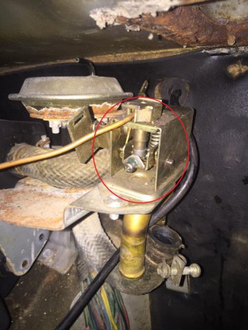

scruz32 Posted December 14, 2015 Share Posted December 14, 2015 Hello guys, I am in the process of replacing the heater core on the 77 280z. I have removed just about everything but now I'm stuck on how to remove the cooper wire that goes into the heater valve. can someone tell me the best ware to remove it without damaging the cooper wire. it seems to be in the way of removing the side door to pull out the heater core. See the picture I have provided. Quote Link to comment Share on other sites More sharing options...
Pillar Posted December 15, 2015 Share Posted December 15, 2015 I just did this last month. There are two Phillips head screws holding that assembly (box that the copper wire goes to that you have circled in the phot) to the heater valve. The best way that I found was to remove the whole valve assembly (requires disconnecting all the heater hoses) then gently pull the whole assembly down and out from under the dash being careful not to kink the copper line. This's allows you to get a better angle on the two Phillips screws ( which are normally a bit tough to break loose). After that, you should have no problems pulling the core out. I would suggest replacing all of those hoses while you are down there as well as they often dry out and weep. Those hoses are hard to find direct replacements for at a reasonable price. What I did was go up to the local auto parts store (AutoZone, Advance, Oreilly, etc.) and ask to go through their heater hoses and find something that is close. I was able to find exact matches for two of them, and one that was close enough to trim and fit. I will see if I till have the part numbers for the ones I bought so you could just have them get you the same ones. I'm pretty sure still have the receipt somewhere. Hope that helps. Pillar Quote Link to comment Share on other sites More sharing options...
scruz32 Posted December 15, 2015 Author Share Posted December 15, 2015 Pillar thanks for the reply! I will try that now since I'm ready to move forward. Please let me know the parts numbers of you still have that info. If not that's cool. Quote Link to comment Share on other sites More sharing options...

scruz32 Posted December 16, 2015 Author Share Posted December 16, 2015 Thanks draztik280z. Pillar, your instructions where right on. Quote Link to comment Share on other sites More sharing options...
