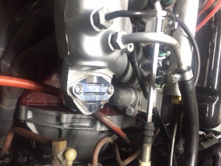

Hello guys, I am in the process of replacing the heater core on the 77 280z. I have removed just about everything but now I'm stuck on how to remove the cooper wire that goes into the heater valve. can someone tell me the best ware to remove it without damaging the cooper wire. it seems to be in the way of removing the side door to pull out the heater core. See the picture I have provided.
