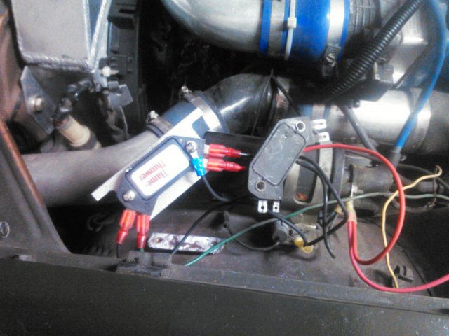

I have a 77 280z with a l28et swap running turbo dizzy and gm 4 wire HEI on megasquirt.  I went to swap the no name module out for a pertronix d2000 flame thrower to rule out a random no spark issue.  I swapped it in and it will start and idle fine but as soon as you give it any throttle it starts to lope bad like it's getting spark cut out.  Swap the old module back over and it runs fine.  Anyone run into a similar issue with a d2000 module?
