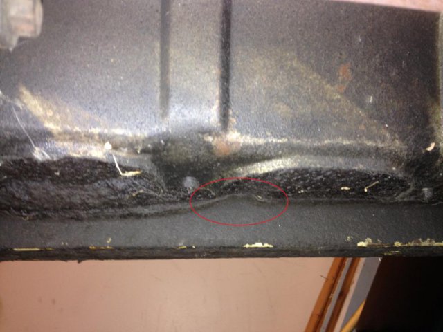

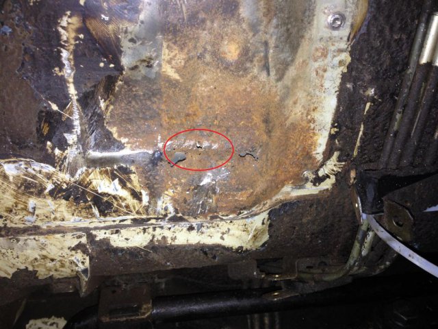

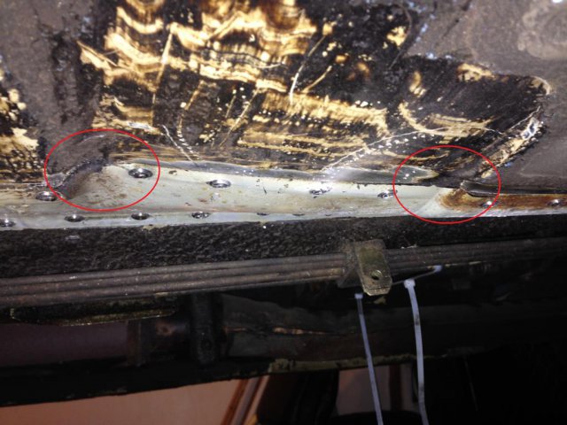

datsunmike Posted April 18, 2016 Author Share Posted April 18, 2016 Took me a while (ordered new floors) but I finally took some pictures. You can see in the first picture circled an area where the folded edge of the rail connects to one of those uneven dips in the floor on the side where I didn't remove the rail yet. The second pic shows the passenger floor how it looks after I removed the rail. You can see the areas where there are dips. There are a few along. Third pic, new rail and flor completely straight and flat Fourth pic, only rusted area in the entire floor pan at the rear tip of the old passenger rail. So here is my dilemma. My first idea was to simply order new floors that would be completely flat, cut everything up and have a nice time welding flat rails on a flat floor. But after inspection, only one area of about 4x4 inch is rusted and needs replacement. The rest of the floors are in great shape, still on primer. Drivers side rails are also perfect. I do know that it's better to do it while i'm at it, that's why I ordered floors, but really the original floors are in good shape except one small area which I could probably patch easily. So I guess I'm looking for opinions, should I bite the bullet and redo everything, or is there a way to weld those rails nicely to the original floors. Quote Link to comment Share on other sites More sharing options...
gnosez Posted April 19, 2016 Share Posted April 19, 2016 240 and early 260 OEM floors are flat as are good replacement replica floors (Zedfindings) while the 280 floors have a number of contours. You can put 240 floors in a 280, use 240 rails and seat brackets (no one that I am aware of makes replacement 280 seat brackets). The 280 rails we sell are modeled after the floor pan of very clean and unmolested '75 so they have the correct contours. Quote Link to comment Share on other sites More sharing options...
