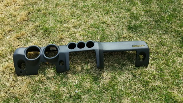

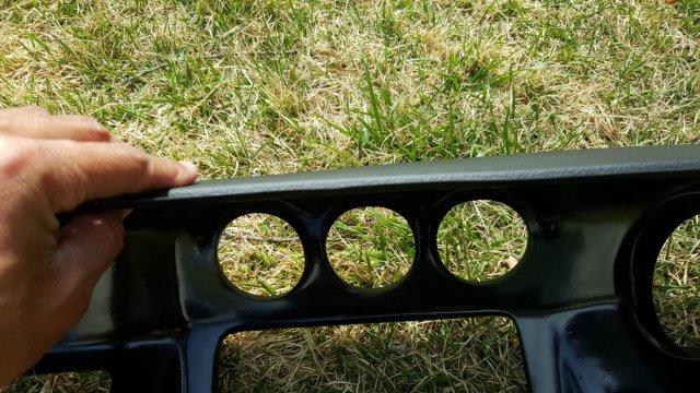

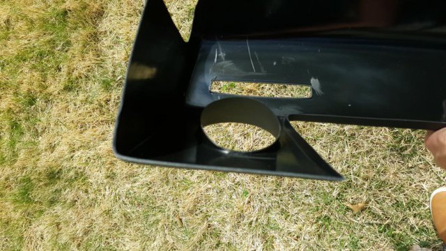

Craig76z Posted April 21, 2016 Share Posted April 21, 2016 Well my cap just arrived. I have to admit that I didn't even think about finding out about the thickness before purchasing, I just looked for the cheapest one. So, here's the review. I got what I paid for. It looks good but it's about three times as thick as a child's Halloween mask. The openings for the three center gauges are slightly oval-shaped. I may be able to work that out. Quote Link to comment Share on other sites More sharing options...
