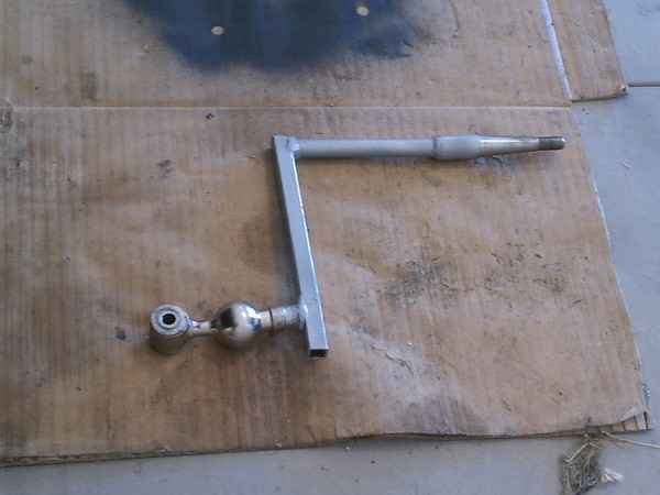

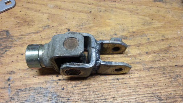

Geno750 Posted May 22, 2016 Share Posted May 22, 2016 To shorten things that much you'll likely need a new linkage. I'll take a picture of the piece I'm talking about later today when I'm home to illustrate. Quote Link to comment Share on other sites More sharing options...
makaofox Posted May 22, 2016 Share Posted May 22, 2016 That's my set up. Takes out a solid 4-5in which makes it much closer to where it would be comfortable to use the shifter. Quote Link to comment Share on other sites More sharing options...
Shock_Strauss Posted May 22, 2016 Author Share Posted May 22, 2016 That's my set up. Takes out a solid 4-5in which makes it much closer to where it would be comfortable to use the shifter. Thanks for the pictures. Honestly that would be perfect if it was moved up further forward. I believe that's when you start having problems due to the linkage. You don't have it installed in the car yet right? This would be perfect: https://scontent.cdninstagram.com/t51.2885-15/s640x640/e15/12728443_1032323470174624_271092311_n.jpg?ig_cache_key=MTE4NTEzMzc2MzQ1ODAyNDkzMQ%3D%3D.2.l I wonder how they did it? Possibly shortened the rod the linkage attaches too? When I have some free time, I'm going to pull the transmission and take a look what kind of modifications I can do. Quote Link to comment Share on other sites More sharing options...
Geno750 Posted May 22, 2016 Share Posted May 22, 2016 They had to of shortened the rod the linkage attaches to. The pictures above are the same as my setup. Quote Link to comment Share on other sites More sharing options...

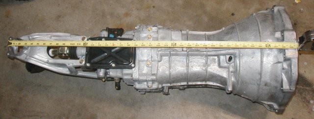

makaofox Posted May 22, 2016 Share Posted May 22, 2016 From the pic the 350z trans is 39in-40in long stock. After cutting the shaft its at 31in. Accorrding to the transmission dimension thread Nissan Type A 4 SpeedWeight: 70 lbs.Length (bellhousing to end of tailshaft housing): 31"Shifter position (bellhousing to center pivot): 31"Nissan Type B 4 SpeedWeight: 72 lbs.Length (bellhousing to end of tailshaft housing): 31"Shifter position (bellhousing to center pivot): 29"G-Force T5 5 speedWeight: 101 lbs.Length (bellhousing to end of tailshaft housing): 31.5"Shifter position (bellhousing to center pivot): 29" - aftermarket Long shifter So in theory the 5sp 280z trans is only 1-2in off. So it should still fit without cutting. At the same time also depends on how far back the motor sits. But thats up to how its mounted. It seems like it will fit no issues. Soon ill be bolting it up to the motor and finding out within a week or two. Quote Link to comment Share on other sites More sharing options...
Shock_Strauss Posted May 25, 2016 Author Share Posted May 25, 2016 So in theory the 5sp 280z trans is only 1-2in off. So it should still fit without cutting. At the same time also depends on how far back the motor sits. But thats up to how its mounted. It seems like it will fit no issues. Soon ill be bolting it up to the motor and finding out within a week or two. Interesting, I think it's probably due to how far back my engine is then. Curious to see how yours comes out. Wasn't able to do much this last weekend due to the rain and probably won't have any major updates in the next two weeks. Started working on attaching the body harness to the bulkhead connector and noticed two wires for the headlights were severely corroded. This might have been one of the reasons I had issues with my headlights. I went ahead and disassembled each of the pins from there housings. Once that was done I submerged them in a vinegar salt mixture for about 15 minutes or so and wire brushed what remained. I then soaked them in water and baking soda to neutralize the vinegar/salt. This procedure has actually been working really well for me. Quote Link to comment Share on other sites More sharing options...
