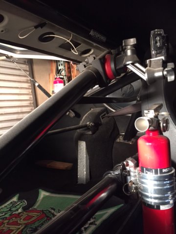

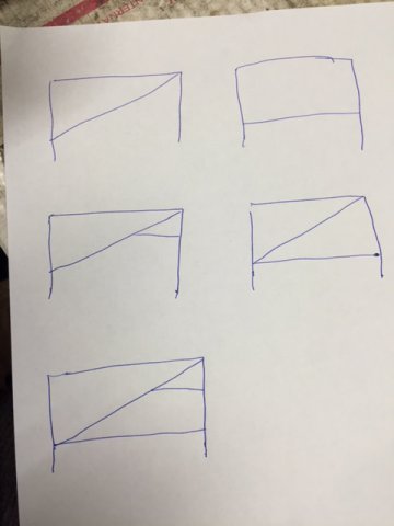

These are the different Autopower Roll Bars that I have gone through to get the one in the last picture.
Current one has all the previous bars.
Hoop (Decal)
Diagonal (Camera)
Horizontal harness bar (Fire extinguisher)
Strap in discussion (nothing attached)
ritrebor
Edited by ritrebor
Jon ,
I'm guessing when you thought it was supposed to be a harness bar you used it as a harness bar for sometime ?
I will have another tube welded for the harness
No, I never used it. It's way too small to hook harnesses to IMO.
They did have a cage that built off of that roll bar and was SCCA legal at one time. Real weird door bars. I don't think it would be legal today. Had a front section that bolted onto the roll bar.
