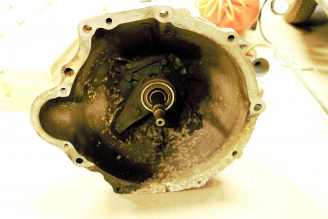

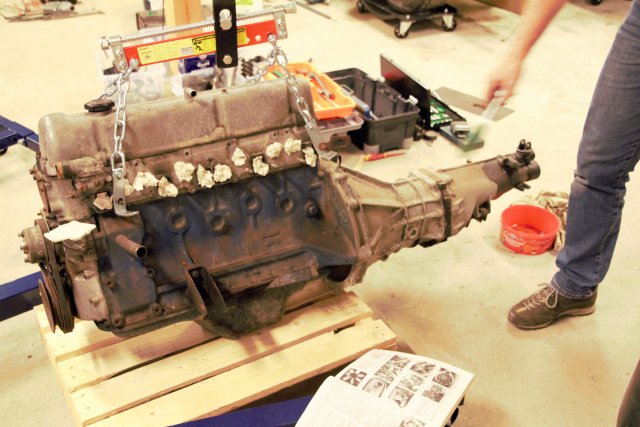

the FS5C71B has a combined bell housing and front gear case as well (courtesy JDM junkies). I have to confess that I'm not 100% certain I have an FS5C71B gearbox, but it makes the most sense as my car is the right year and market to have one...The value of a restored original gearbox is a good point. I actually have two gearboxes with the same housing (at very similar).. so I plan to keep one original and restore it for future use.59f76a4d7d2de_FS5C71BvsFS5C71A.thumb.jpg.c888ce9d3031d435c7bbd05ae69f9181.jpg

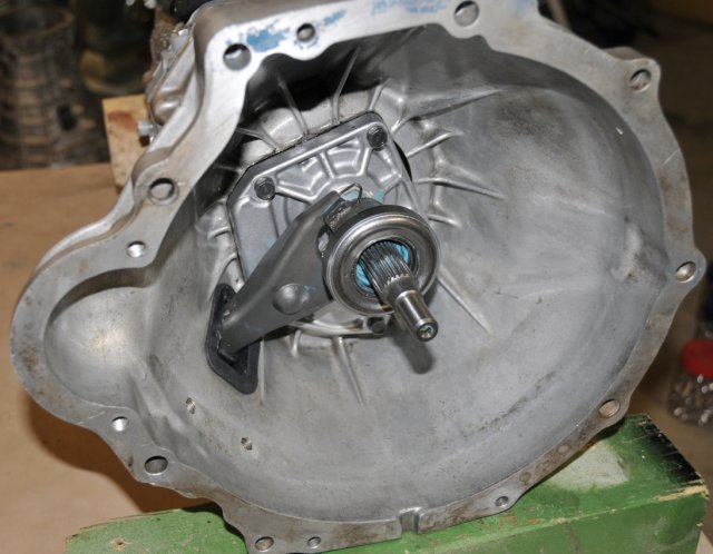

FS5W71B housing from http://zhome.com/ZCMnL/tech/240SX5spd/transmission3.htm
IMG_1143.thumb.jpg.b29912bedbea5d4f3155a202342eca38.jpgIMG_1140.thumb.jpg.73a434cd2a83e13e2bd458b914d5f61e.jpg
My gearbox as taken out of the car... looks promising at least. I might pick-up the FS5W71C gearbox anyway as I can get my hands on it quite cheap.
