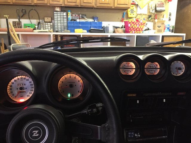

ben a Posted March 6, 2018 Share Posted March 6, 2018 i think i have the oil pressure figured out now i am doing temp. For some reason my wife wants the original gauges she has everything inside the car original and new. I am working with a ls1 from a 2004 GTO it has two locations for temp senders and i will be trying to keep the sender that talks to the GTO computer and add one that matches ohms with the unit from the old 240z engine. i dont know how well this will work so i thought maybe someone on here might know. thanks Quote Link to comment Share on other sites More sharing options...
