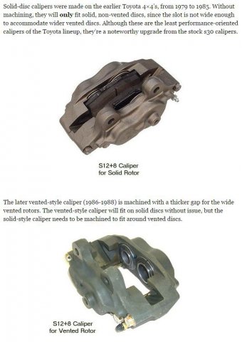

walkerbk Posted September 17, 2018 Share Posted September 17, 2018 If you use the s12+8 calipers from the later years, they were machined to fit vented roters like the s12w ones but have smaller cylinders making for more of around 57% to 43%. This is what I run and am very happy with the setup. 1 Quote Link to comment Share on other sites More sharing options...
Miles Posted September 17, 2018 Share Posted September 17, 2018 (edited) 45 minutes ago, walkerbk said: If you use the s12+8 calipers from the later years, they were machined to fit vented roters like the s12w ones but have smaller cylinders making for more of around 57% to 43%. This is what I run and am very happy with the setup. Good point. Edited September 17, 2018 by Miles Quote Link to comment Share on other sites More sharing options...
