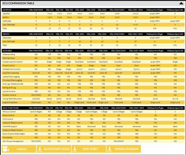

Chickenman Posted June 22, 2019 Share Posted June 22, 2019 Haltech Elite 750. One of Health's entry level ECU's, but it is purpose built for 6 cylinder engine. Comes with 6 logic coil drivers and 6 High or Low Z injectors drivers. The Low Z injector drivers are true Peak and Hold drivers. Not the cheaper, slower and less accurate PWM Current limiting drivers found on some popular " Build it yourself " ECU's. For a single Ignition coil you will need an external power amplifier. 0v to 5v logic level. The Nissan PRW-2 module is a perfect match. You can find them used for about $10 on E-bay. The Nissan OEM PRW-2 modules are powerful and last forever. Used original Nissan Modules are preferred over Chinea manufactured crappola. Like OEM GM LS-2 coils over aftermarket clones. Quote Link to comment Share on other sites More sharing options...
Chickenman Posted June 22, 2019 Share Posted June 22, 2019 Link G4+ Storm is also a good alternative. But the Elite 750 is a very nice ECU. I've tuned both... which is one reason I'm getting away from tuning a different " Build it yourself " brand. The difference in quality of a " REAL " ECU is amazing. Haltech and Link just work properly out of the box. Period. Quote Link to comment Share on other sites More sharing options...
Andre Jolibois Posted June 27, 2019 Author Share Posted June 27, 2019 Thanks Chickenman. What about the Elite 1000? The only shop I could find by me is thinking of the Elite 1000. I do not believe he is familiar with the Z turbo engine. Any recommendations for a shop with dyno in Chicago, Illinois? Quote Link to comment Share on other sites More sharing options...
Chickenman Posted June 28, 2019 Share Posted June 28, 2019 (edited) Elite 1000 only has 4 Ignition Drivers and 4 Injection drivers. I would go with the Elite 750. It is purpose built for 6 cylinder engine and will do everything you need. Go to the Haltech Group on FB. Look up Claudio Taverus Peynado . He used to work for Haltech and has his own shop now. He is a Haltech distributor. https://www.facebook.com/groups/haltechtuningandtips/ https://www.haltech.com/product-overviews/ Edited June 28, 2019 by Chickenman Quote Link to comment Share on other sites More sharing options...
Chickenman Posted June 28, 2019 Share Posted June 28, 2019 (edited) You can compare the different Haltech ECU's here: https://www.haltech.com/product-overviews/ They also have Videos and a comparison chart. The Elite 1000 has a few more advanced I/O features than the Elite 750, but not as many Inj drivers and coil drivers. The 750 is also cheaper than the 1000 . There is a trade-off between more features or more drivers. There are comparison Charts at Haltech. You may not need the Launch control, Traction Control or Knock control. ( Since the L28 has no knock sensors ) Edited June 28, 2019 by Chickenman Quote Link to comment Share on other sites More sharing options...
