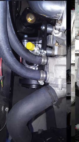

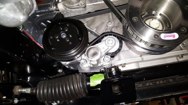

AC compressor installed. I bought the kit from DIrtydingo Motorsports. The kit mounts the AC compressor low on the passenger side of LS engines. The kit uses a Sanden SD7B10 compressor. I had to modify the lower bracket to get the tensioner to clear the steering rack. The compressor clears the 240Z frame rail, no modification needed. Next is installing the condenser and dryer, then running the AC lines through the passenger front fender vent channel.
