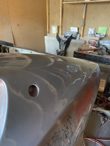

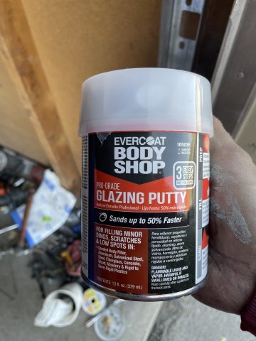

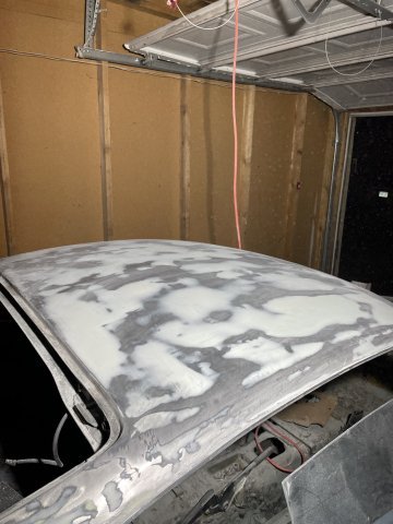

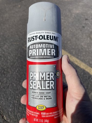

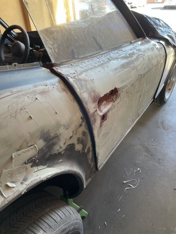

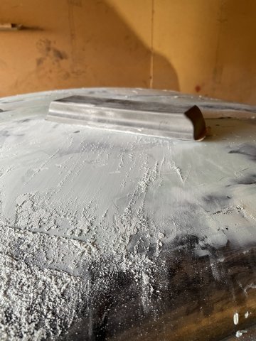

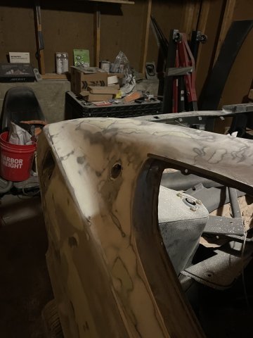

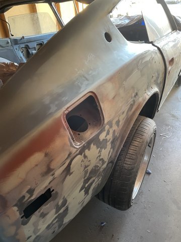

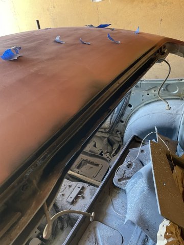

A to Z Posted January 1 Author Share Posted January 1 thanks a lot. I added a bit more hardener and then no problem. I will post pics later, but I put a thin coat of black primer right on the steel and then blocked it this morning. Did the same with the sail panels. It worked great. I then wiped it down with rubbing alcohol and put pieces of blue tape in all the low spots that filler primer won't fill in. I will use glaze with a hardener now. I am well versed with it and it is so easy to work. I just want a decent job, I don't need a show car body. when all is said and done, if the clear doesn't "pop" enough, I will wipe on a coat of glossy Poppy's patina. Poppy's Patina - The Original Patina Clear Coat. 1 Quote Link to comment Share on other sites More sharing options...

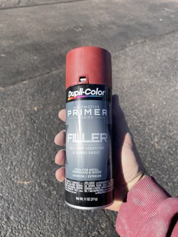

A to Z Posted January 2 Author Share Posted January 2 I'm keeping it simple and easy to get done. not going to a mirror finish, just a factory level finish. I build drivers, Sir. I was going to use that dry guide coat until I realized you can't paint over it.....so it is ANOTHER step to get it off then put the mud when you took it off, then smooth it out then another guide coat then block. I just used black primer, mud the deepest bottoms, and use about 4-5 coats of the THICK primer filler made by duplicolor.....specially made for deep scratches. red oxide color. Not advocating any of this it's just experimentation and finding a way that works for me. It will go quick this way. Mud only where needed. when you cover the whole panel, 90% is sanded right off. Using glaze, it sands so easy, I can block it with 220 grit within about a hour and have it ready for filler primer....will it be razor straight? No....but it will look pretty nice. 1 Quote Link to comment Share on other sites More sharing options...

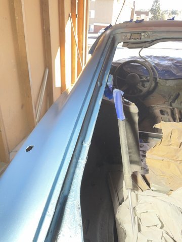

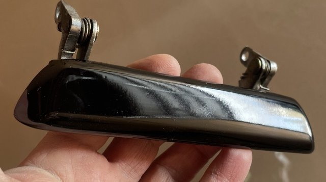

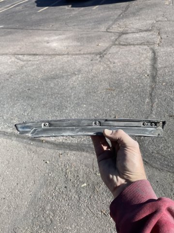

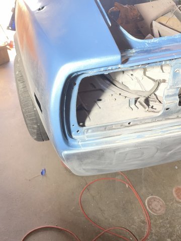

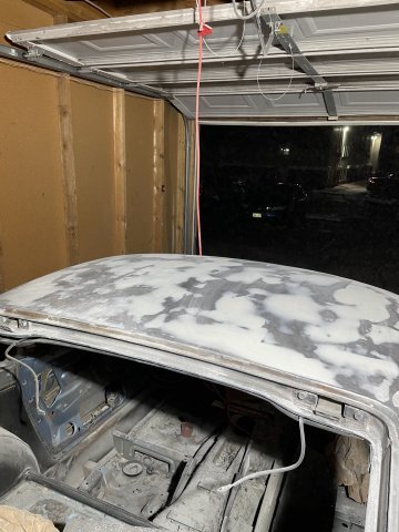

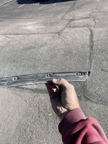

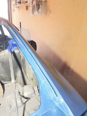

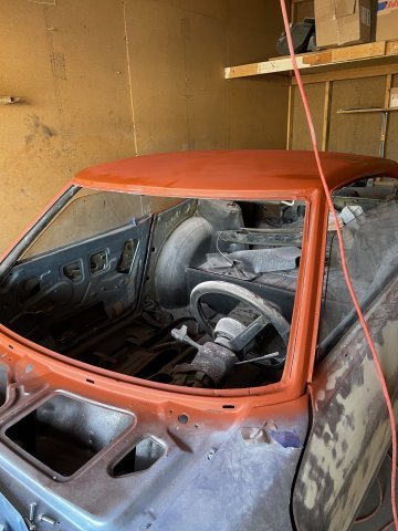

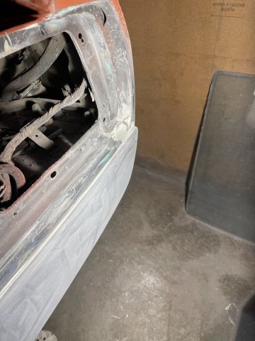

A to Z Posted January 8 Author Share Posted January 8 01-03-2026. Ok so today i pulled the door handles, locks quarter windows and main window frames. they are going to the powdercoater. i got the rear roll pan installed right where inwanted it and sealed down, later inwill put a bit of filler (glaze) around it and the rear will be done. i got the roof and sailmpaels done. it will now get filler primer and a quick look over and get all the edges etc ready for sealer and paint. very productive day! pics: Quote Link to comment Share on other sites More sharing options...

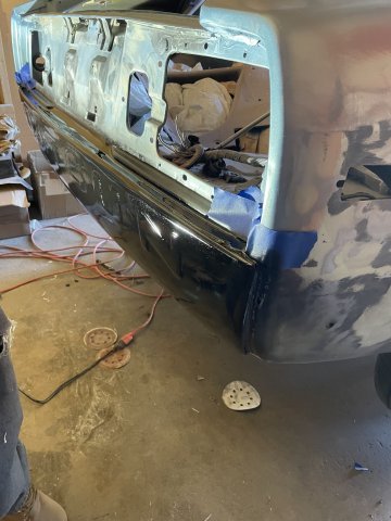

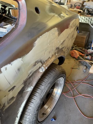

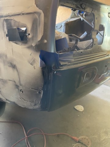

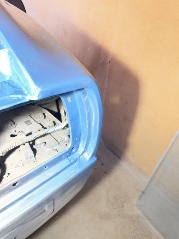

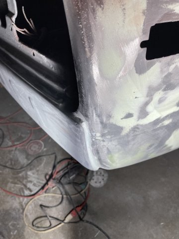

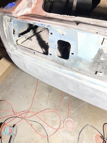

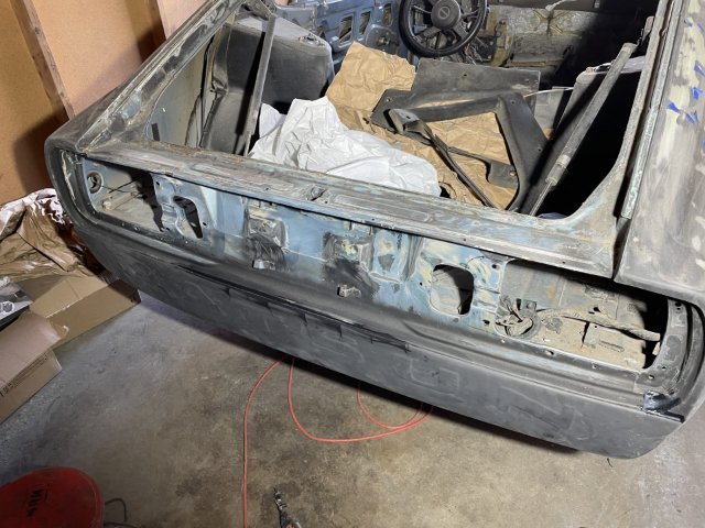

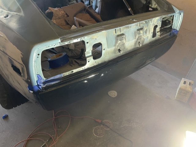

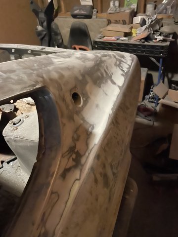

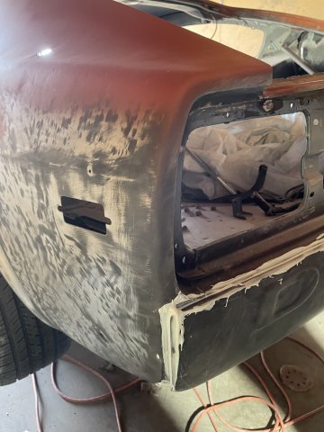

A to Z Posted January 8 Author Share Posted January 8 01-04-2026. More time in the garage today. I got the radiator support area painted up and got the roof and sail panels coated in multiple coats of filler primer. I then went ahead and got some filler in around the top and sides of my rear roll pan, and after it was dry I got it all sanded out. I am now about 95% done with the tail. It's ready for final paint....but I need to do the cuts for the 240Z taillights and make sure the taillight panels fit the way I want them to. The filler primer made it possible to see the condition of the roof and sail panels much better, especially holding the light in one hand and looking across it. more work needed PICS: Quote Link to comment Share on other sites More sharing options...

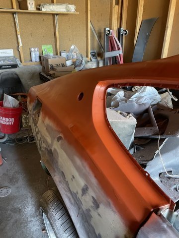

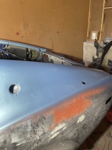

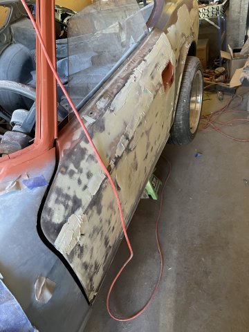

A to Z Posted January 8 Author Share Posted January 8 01-07-2026. I got the sail panel on the drivers side painted, and the hatch jambs up to where it will change to black, the taillight surround....and the other sail panel then ran out of paint, so waiting for paint to arrive. I put filler on the spots on the doors and quarters that were still waiting to be done, and it hardened up so even though this weekend will be cold, and I can sand those down and get them done. I also painted the roll pan, and that exposed a little work needing to be done and I got some runs, so I will have some paint correction. Nevertheless, it gives a good idea what it will look like, and real progress was made in just a couple hours. you can really tell a difference in the blue before and after the clear coat! PICS. Quote Link to comment Share on other sites More sharing options...

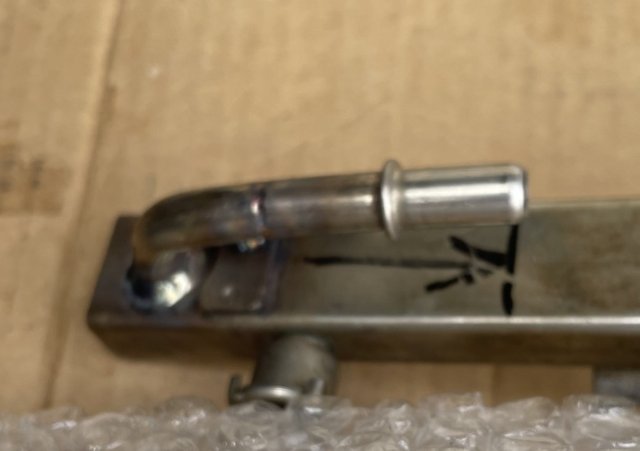

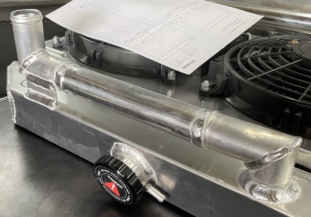

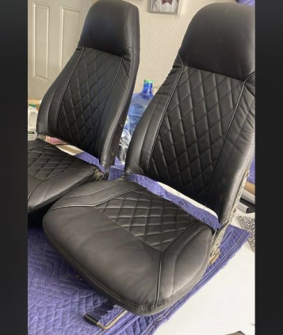

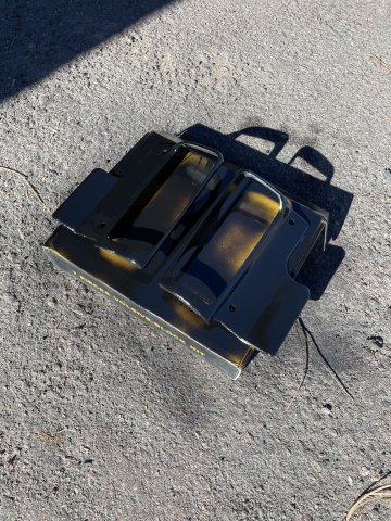

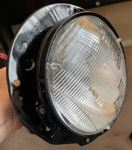

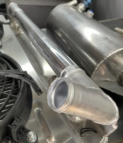

A to Z Posted January 9 Author Share Posted January 9 01-09-2026 UPDATE: several things coming together on my 260Z ATLAS Z 4.2 project. I picked up my fuel rail that I had modified so the hookup to my PTFE hose will be clean and how I want it, and the radiator I got back as well. You can see the crossovers are done.....now the radiator hookups match the engine, note the reinforcement plates he welded in to support the pip runs. I also picked up my seats from the upholsterer with the seat covers I found on eBay. Lets see......I picked up another batch from the powder coater, door handles, window frames and headlight frames.....which I have cleaned up and restored. The dash center panel came in from Skillard....and it is cool that he sent a new sticker and large pic of his Z car to hang up in the garage. Lastly, my header studs came in from Atlas Enterprises. It is VERY COLD out today, but I will try to get out to the garage this weekend and try to get most of the sanding done so the rest of the shell can go into paint. PICS: Quote Link to comment Share on other sites More sharing options...

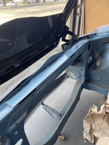

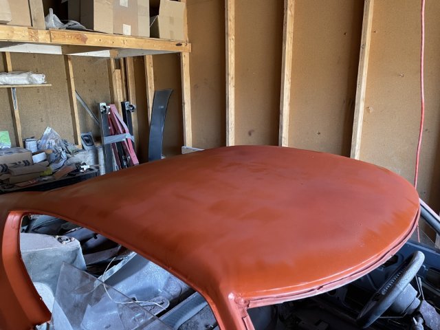

A to Z Posted January 15 Author Share Posted January 15 01-14-2026. Prepped for more paint. I was able to get the body ready for more paint, and I will paint it, knowing I will see spots later that I can spot repair/fix if needed. this will get it to about 95% on being completely painted. Working on the body is such that you could spend a year and still find things to "fix".....and I think it's time to "push" it forward. After getting it ready for paint, I installed the radiator finger tight and the cut down radiator engine inlet I got from 42004U.com. I then grabbed the intercooler and put it in there to get some measurements for making brackets. I grabbed one of my 90's do this as well. TIME FOR MORE PAINT! Quote Link to comment Share on other sites More sharing options...
A to Z Posted January 15 Author Share Posted January 15 01-15-2026. PAINTJOB. Ok so it is painted now. there are a few spots I can later address and spot paint, but the major paint and bodywork is done. PICS: Quote Link to comment Share on other sites More sharing options...

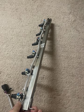

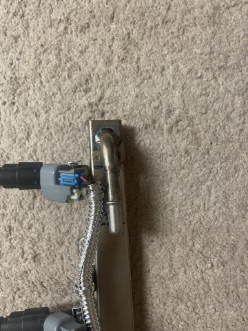

A to Z Posted Sunday at 01:37 AM Author Share Posted Sunday at 01:37 AM 01-24-2026. Well, I went ahead and put my fuel rail together today. My factory rail I had the port for the fuel line hookup cut and custom welded on by Wagner Fabrication here in Colorado Springs, CO, for a cleaner look, and the wiring was custom made by Jemery at Lime-swap. Injectors are Siemens DEKA 60 lb EV6 injectors from TRE. You can see I put the chrome wire loom on as well and used some chrome tie wraps to make it look half decent. PICS: Quote Link to comment Share on other sites More sharing options...
A to Z Posted Sunday at 08:55 PM Author Share Posted Sunday at 08:55 PM Ok, so according to TRE the numbers I mentioned are static and Dynamic values for each injector, and are used by the tuner. Cyl Static Dynamic 1 - 600 103 2 - 606 104 3 - 588 102 4 - 594 103 5 - 594 104 6 - 600 103 Interesting. Glad I took the time to keep track of which one is in which cylinder. Quote Link to comment Share on other sites More sharing options...
