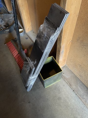

A to Z Posted January 31 Author Share Posted January 31 10 gallon fuel cell from evil energy arrived. it fits! very nice quality. Last pic is from the Skillard site, but I just bought this floor and will be using it with this fuel cell and a battery box. Quote Link to comment Share on other sites More sharing options...
74_5.0L_Z Posted January 31 Share Posted January 31 That type of fuel cell is only good for drag racing and mild street driving. I had something similar in my car when I first built it. When I started auto crossing the car, I found that the fuel had to be kept almost full to prevent starvation during braking and cornering. Quote Link to comment Share on other sites More sharing options...
