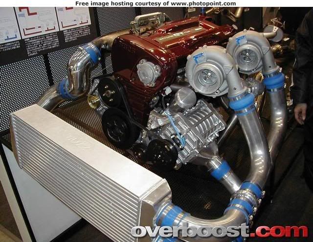

stony Posted October 17, 2004 Share Posted October 17, 2004 this picture has been posted before but here it is again. a twin turbo supercharged rb26!!!! Quote Link to comment Share on other sites More sharing options...
