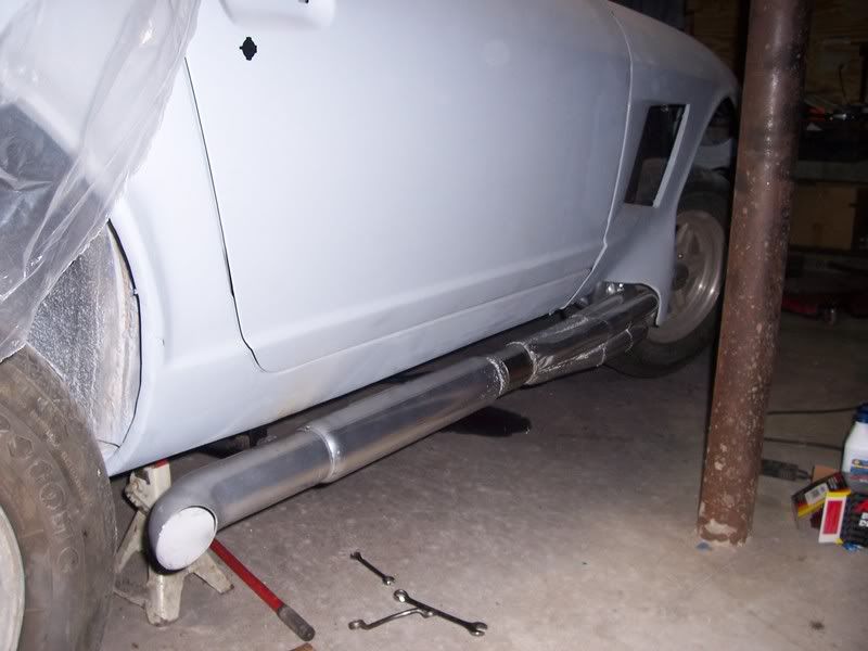

DavyZ Posted October 23, 2007 Share Posted October 23, 2007 motor mounts are from heidt's rod shop, headers are custom fenderwell to sidepipe headers. I spent six months of spare time measuring and routing the headers. I recently had the headers hot-jet coated. This project has evolved alot since I started. Davy Quote Link to comment Share on other sites More sharing options...

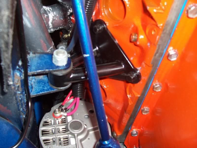

ron adams Posted October 23, 2007 Share Posted October 23, 2007 here's the motor mount I used: headers: better pics to follow, its raining. Quote Link to comment Share on other sites More sharing options...
