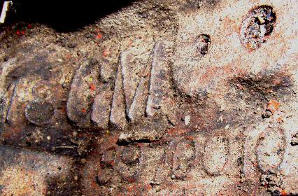

Guest Cossack Posted October 23, 2007 Share Posted October 23, 2007 Don't let anyone convince you your eyes are wrong. I have a 1967 Chevy C60 dump truck with: Block Cast *8970010* (unidentifiable)(does not exist) deck 10 143654 V1017CNV Heads *3973487*...350...71........CORVETTE...330,270 HP *3973487*...350...71-76...PASS, CAMARO, CHEVELLE, NOVA,MONTE CARLO...SMALL PLUGS *3973487*...350...71-76....TRUCK.......LIGHT DUTY *3973487*...350...72........CORVETTE...200,255 HP Intake *3877652* = 66 & 67 Intake for Passenger/Chevelle & Chevy II 283's 67 camaro 327/210 HP 1965 *3877652* 283,327 2bbl iron - A B C K,trk Carb 7041110 110 1-CF Year Model Trans Type/BBL OEM Number Line 1971 CAMARO 307" Eng S/T R-2-2GV 7041101 900 A/T R-2-2GV 7041110 901 CHEVELLE, EL CAMINO 307" Eng A/T R-2-2GV 7041110 913 CHEVROLET, MONTE CARLO CHEVY II 307" Eng A/T R-2-2GV 7041110 935 VENTURA II 307" Eng A/T R-2-2GV 7041110 1244 YEAR PART . C/I TRANS MAKE MODEL 1971 7041110 307 M GM TRUCK C/K/P MODELS 1971 7041110 307 A CHEVY CAMARO/CHEVELLE/EL CAMINO/NOVA PART # YEAR BBL's C/I TRANS MAKE MODEL 7041110 1971 2 307 A CHEVY CAMARO/CHEVELLE/EL CAMINO/NOVA So if anyone can identify a Block cast 18 GM 8970010, 10 143654 V1017CNV, Please drop me an email. Dave cossack@spamcop.net Quote Link to comment Share on other sites More sharing options...
