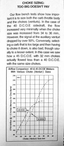

With a P90 head, the thing I need to figure out is if I am limiting the head with the size choke. I may be under powering the head a bit. I dont know what the CFM is for the P90 head, and what the DCOE 152's with a 36 size choke CFM is. Anyone know this info? I assume a CAM also changes this quite drastically. With all the dynamics people change it might be hard to find that info out. My setup is a shave head .080 (10:1 compression), CAM .480 Lift 280 Duration, no other mods on head.
Not sure if this helps you with the P90 CFM answer, but might be of some use to everyone following this thread.  I dont recall seeing this picture/graph in any of the other pages, but I came across it in a post on side draft central.  The graph compares 40's vs 45's CFM's for multiple venturi sizes.
According to the chart, 45 DCOE's with 36 venturis should be flowing roughly 205 CFM's @ 1.5 inches of mercury per barrel.

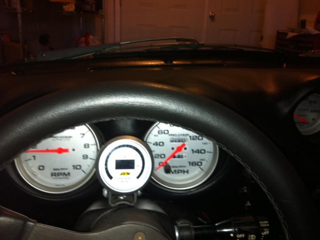

I mounted the AFR gauge on the clamshell cover in between the speedo/tach using one of the universal gauge mounts. I'll try to snap a pic tomorrow.
Edit: here is the picture.  I think you can buy the mount for like $10 (also from Amazon) and its just 2 small holes drilled into the top clamshell cover and barely "screwed" in (threads barely go through the cover and are basically flush to the underside).  I'm sure it could be mounted elsewhere.  Wiring was a breeze.  Just power and ground needed to get it running.
