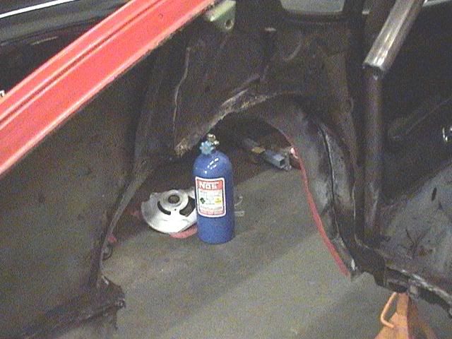

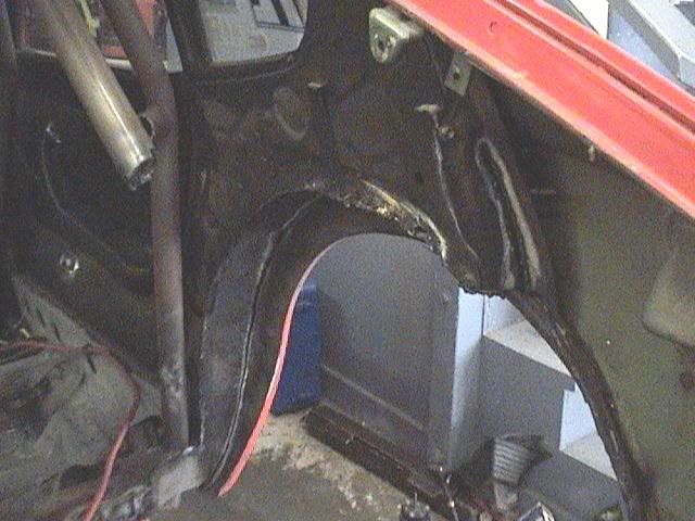

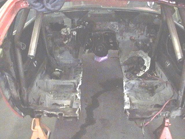

stony Posted October 4, 2004 Share Posted October 4, 2004 I pulled off a 11.138@ 121 and a 1.65 60 foot with mine when it dynoed at 352RWHP. This was with the stock rb26 stock booste and injectors. my car wieghed 2800 with me in it. as soon as i turned up the booste and started getting traction i started breaking rearend stuff. 8.99 OR faster you will want a full chassis. mine will be certifed to 9.00 and it has to have bars that go thru the firewall to front struts. the only part of the floor that is left is the section just under the seats. here's a pic. Quote Link to comment Share on other sites More sharing options...
