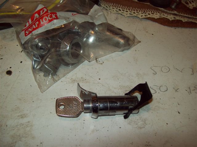

y-not Posted October 4, 2006 Author Share Posted October 4, 2006 This is a picture of the ones that I made. Bill Quote Link to comment Share on other sites More sharing options...

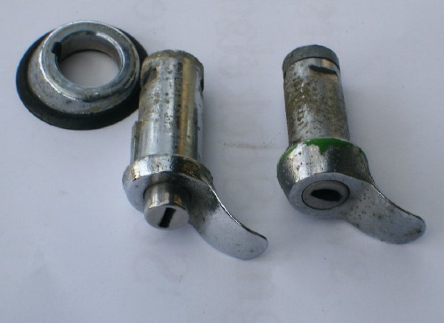

SpeedRacer Posted October 6, 2006 Share Posted October 6, 2006 Here ya go Duke This is a picture of the Honda type door button installed on my GTO replica. I routed out a small part of the fiberglass door panel using a rounded tip and then picked up an O-ring from the hardware store. Slide the O-Ring over the lock mechanism and push tight against the door panel while installing the retaining clip from behind. This keeps the button from marking the door panel paint and keeps it tight so it doesn't rattle. Also, the Honda door button is manufactured with a rectangular boss running down its length. I ground a square notch in the circular retainer so the button would not rotate. BTW, if you study the original GTO pictures you will see some of the cars had the finger pull facing downward and some had it facing towards the back of the car. Quote Link to comment Share on other sites More sharing options...
