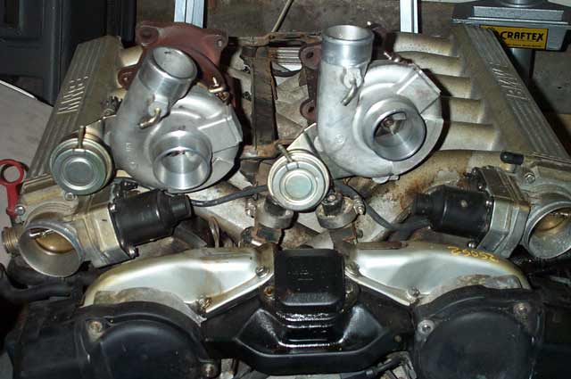

Yeah, twin turbo 5 litre v12 is filling me with trepidation (especially when putting my foot into it in a 2300lb car), but I'm sure the ooooh-aaaah factor will be worth it.
I'm struggling with the oilpan issue still. Haven't decided if I'm going to go with a dry-sump system or rework the front cross-member and steering rack...

The V12 has two ignition systems ... one is the electronic system, and there's the fail-over system, which is actually distributor based. When everything's fine, the engine is controlled by the ECMs. If those fail, the engine goes into limp-home mode and uses the distributors exclusively.
If you look at the pic in my post, you'll see two dish-shaped plastic caps on the end of the heads. Below those are 6-post distributors that are driven by the cam shafts. I'm not sure, but I don't see why you couldn't use those to drive the spark (you'd have to check out how to control the advance).

Those dizzies are exactly right. They hide under the plastic covers. That's a purdy engine.
If you like, I could take a peek under the caps and see if there's any set up for advancing/retarding the timing.

As you can see, there's plenty of room before running into the radiator core support. The engine can also be set back another 2" or so too, depending on what tranny/adapter I come up with.
