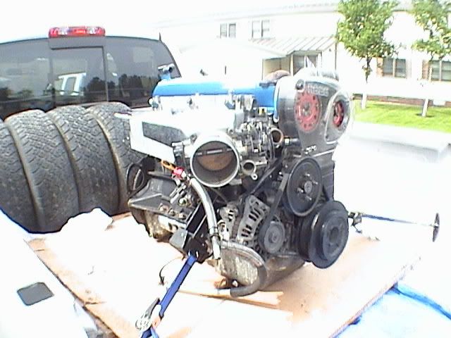

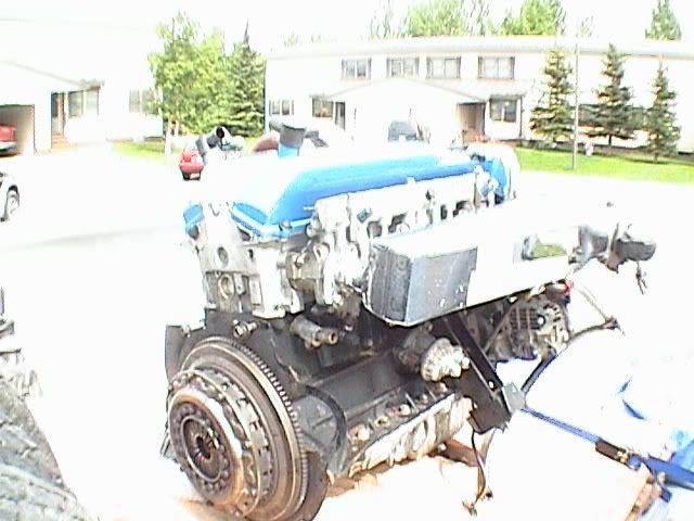

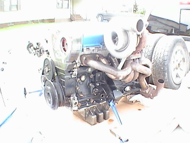

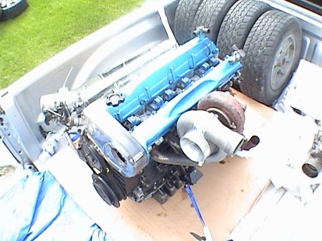

stony Posted February 19, 2005 Share Posted February 19, 2005 I cant rmeember who asked for these but here are the pics of the motor that will be going in the Z once its done. the valve covers are red now. Quote Link to comment Share on other sites More sharing options...

RB26powered74zcar Posted February 19, 2005 Share Posted February 19, 2005 Stony, have you test fit it yet in your engine bay? I'm wondering if it fits ok with that exact manifold/turbo set up. I thought I remembered seeing a post about this, but can't find it. I thought it had to do with the exh manifold interfernce somewhere....? Quote Link to comment Share on other sites More sharing options...
stony Posted February 19, 2005 Author Share Posted February 19, 2005 with the mounts i had on the old setup NO it did not fit.....the compressor housing hits pretty hard on the strut pillar. we are going to move the engine back and tilt it up alittle to cure that though. Or notch the pillar which ever is easier when the time come for the final moc up. Quote Link to comment Share on other sites More sharing options...
RB26powered74zcar Posted February 19, 2005 Share Posted February 19, 2005 so that manifold puts the turbo right in the middle of the strut pillar? what about the w/g pipes... will they be ok? reason I'm asking is, I see that manifold up for sale now and then, and have thought about buying one for when I feel like playing with the BIG SINGLE route some day on my set up. Or..... maybe even doing another rb26 powered Z car but with a single..... just doing some home work... Quote Link to comment Share on other sites More sharing options...
stony Posted February 19, 2005 Author Share Posted February 19, 2005 yes the compressor housing with my mounts sit right in the middle of the strut pillar. the wastegate pipe will need to be cut, shrotened, and refitted to clear the steering linkage. Quote Link to comment Share on other sites More sharing options...
slownrusty Posted February 19, 2005 Share Posted February 19, 2005 Stony...Looks great! Love it...nice work on the manifold (both). Yasin Quote Link to comment Share on other sites More sharing options...
RB26powered74zcar Posted February 19, 2005 Share Posted February 19, 2005 yes the compressor housing with my mounts sit right in the middle of the strut pillar. the wastegate pipe will need to be cut, shrotened, and refitted to clear the steering linkage. gotcha... thanks for the info, and it does indeed look awesome! Quote Link to comment Share on other sites More sharing options...
