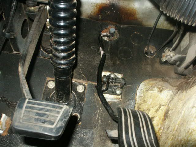

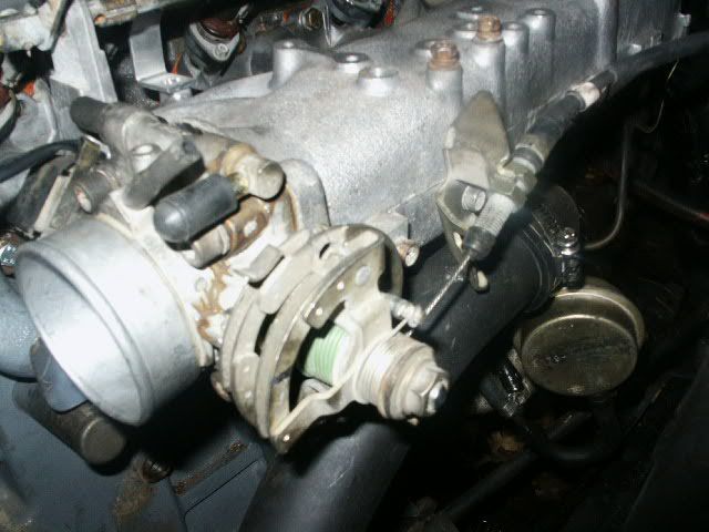

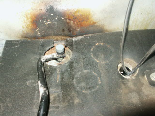

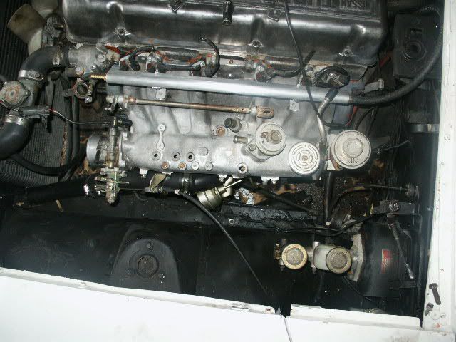

ihatejoefitz Posted April 8, 2005 Author Share Posted April 8, 2005 Quote Link to comment Share on other sites More sharing options...
Tony D Posted April 10, 2005 Share Posted April 10, 2005 I got to ask.... Did you bend the throttle lever IN the car? It sure looks like someone was up there with a blowtorch! LOL But yeah, that is about what mine looks like. On a technical note, I read somewhere that the quadrant should have the throttle cable heading towards it tangentially so I try to set mine up like that and it worked O.K. how is tip-in with your setup, as it looks like the cable mount is a bit higher than it "should" be for the TB position. I considered setting up like that, but with the quadrant on the TOP of the manifold... Gives you a few more alternatives for mounting that cable with the correct angle. Especially if you whack the stock linkage holders off the top of the manifold... Quote Link to comment Share on other sites More sharing options...
ihatejoefitz Posted April 10, 2005 Author Share Posted April 10, 2005 the cable position is definitely temporary, i havent even gotten MS running on my car yet, so it was pretty much impromptu. as soon as everythin is up and running i'll start cleaning up the intake, grinding down the stock linkage and ill probably weld a bracket for the cable to sit in. my guess as to why the metal is so burnt looking right there, is probably because the old cammed and carburated engine would backfire through the carbs for the first ten or so minutes after startup and they were pretty close to that hole. the tip in is not great and is something that ill have to get used to. Quote Link to comment Share on other sites More sharing options...
280zrice Posted May 29, 2005 Share Posted May 29, 2005 helo, i am using the 240sx throttle cable on the inside of the intake along with the spacer and and the 60mm tb, , welded the arm of the 240sx pedal to the to the 280z one , ( my first prototype) fed the cable through the linkage port in the firewall and used the cable mount for the cable end at the tb side attached to a mounting hole in the inake, positioned to the correct distance, on the 240sx tb itself i used the cruise control , half moon cable throttle piece and shortened the shaft to clear the intake , on the potientiometer side, i redrilled the 280z potientiometer to accept the new angle of the mounting screws. my first attempt and it works great, no more linkage i want to adapt it to the origanal tb , to use on the street model to avoid the decel exaust , i also need input on other ideas on clean low budget custom tricks Quote Link to comment Share on other sites More sharing options...
