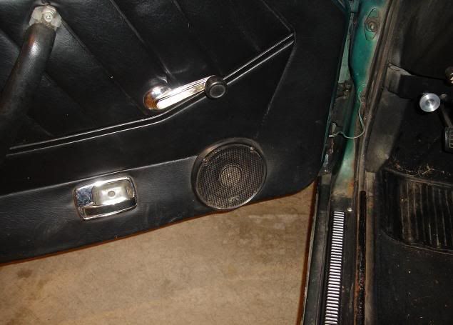

speaking of sound systems..... what problems should i expect to run into when installing two 5 & 1/4th inch speakers in my doors? i'm also going to put two 6x9's in the storage compartments like i did in my old z
my dad bought a couple of speakers that aren't huge thickness wise and are made to be placed in doors. suggestions/tips?
A flush mount 5 1/4" speaker in the door will be a very snug fit. Check everything (whole in metal part of door behind facia panel, armrest clearance & window crank handle clearance) very carefully before you start cutting. Mine has 6 1/2" speakers but they are in custom enclosures that make them more of a surface mount than a flush mount. It is extremely tight with them.
The 6x9's in the back deck area behind the seats should not be a problem. Again - check out the underneath structure before randomly cutting any holes in the hardboard deck.
I too mounted 5.5" 3 way speakers in the doors and 6.5" 2 way Alpines in the rear deck. I also mounted a Rockford amp and 10" sub woofer behind me in the deck area.
I wish Id purchased a Alpine stereo instead of the Pioneer I am running. It's ok but the Alpine is better. Santa got me a second amp just for the speakers, an Alpine 4 channel perfect for powering the 4 speakers in the Z.
