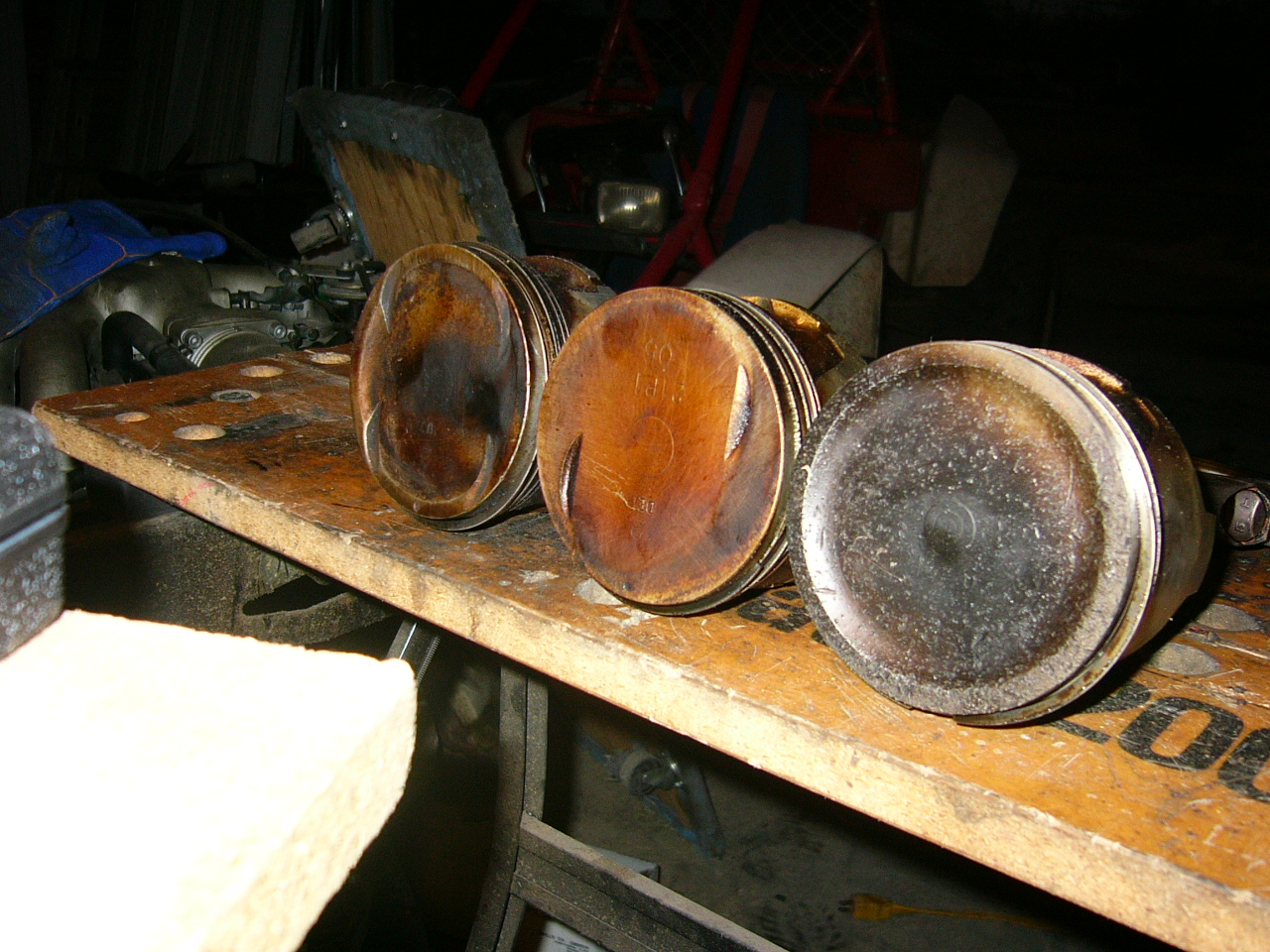

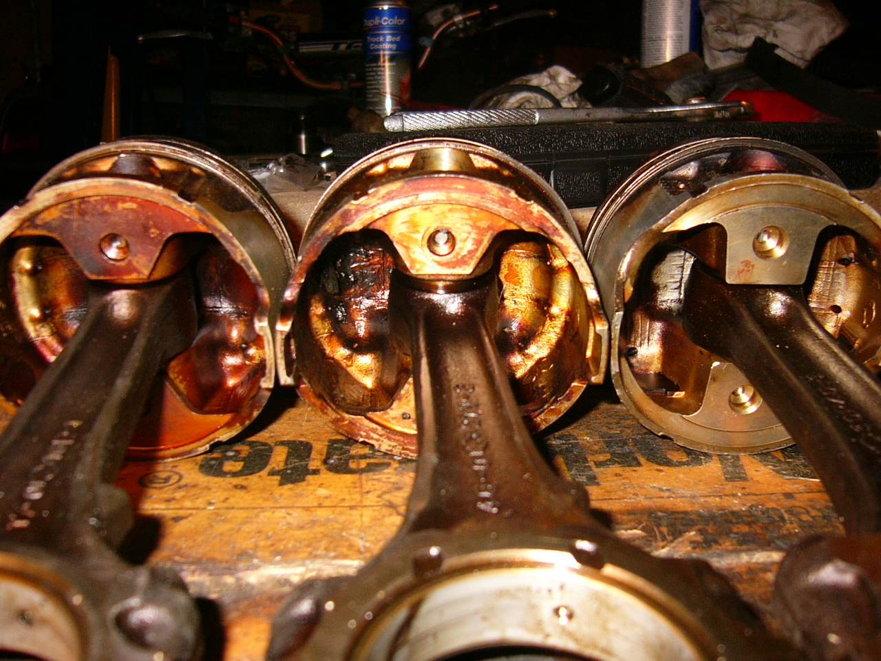

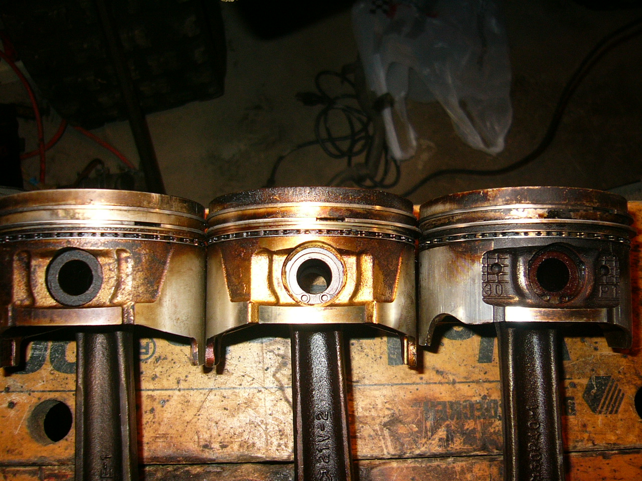

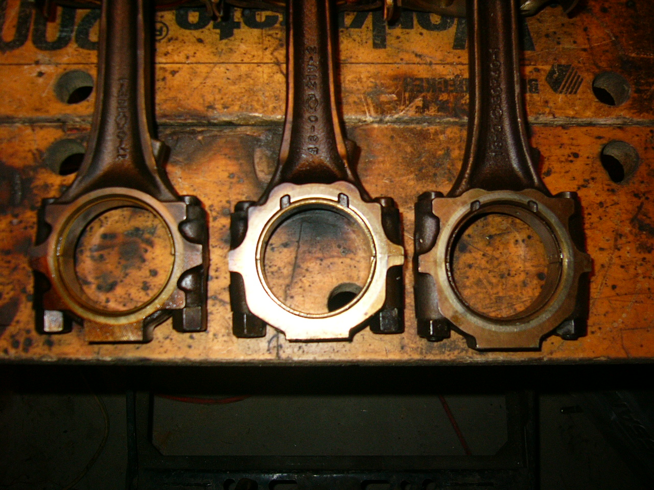

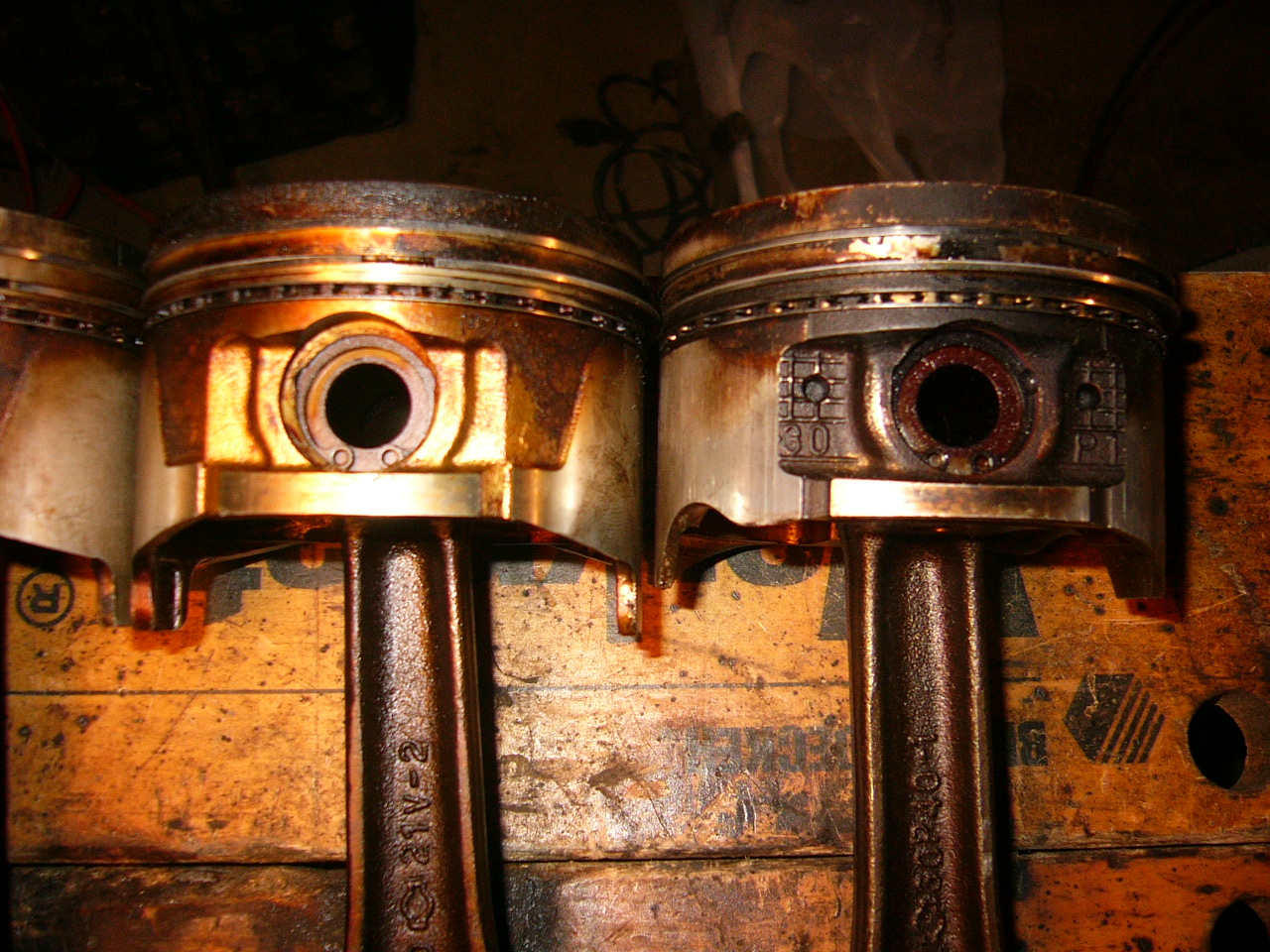

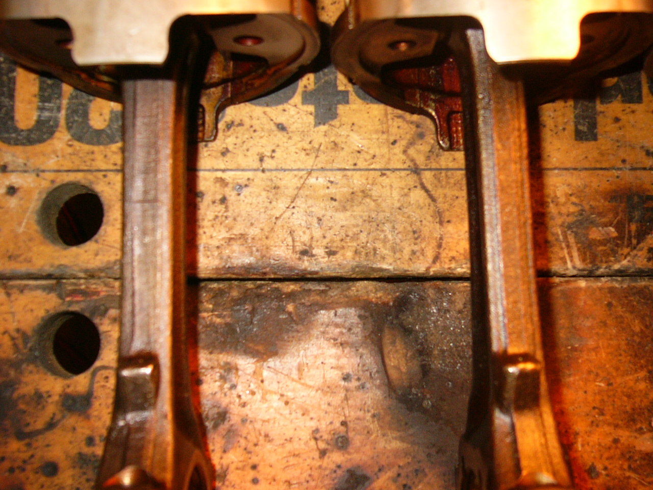

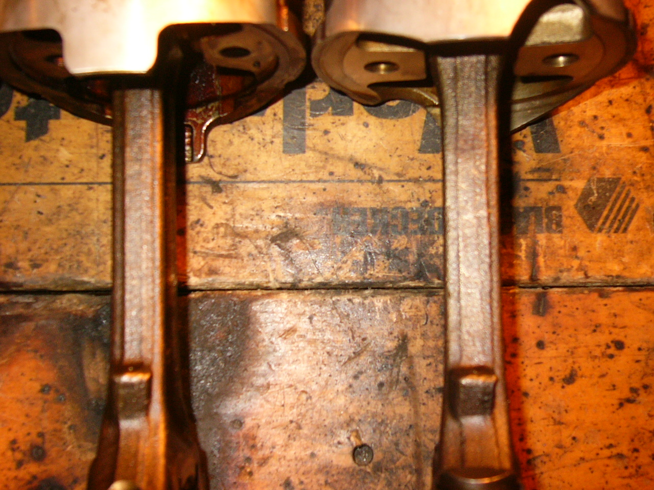

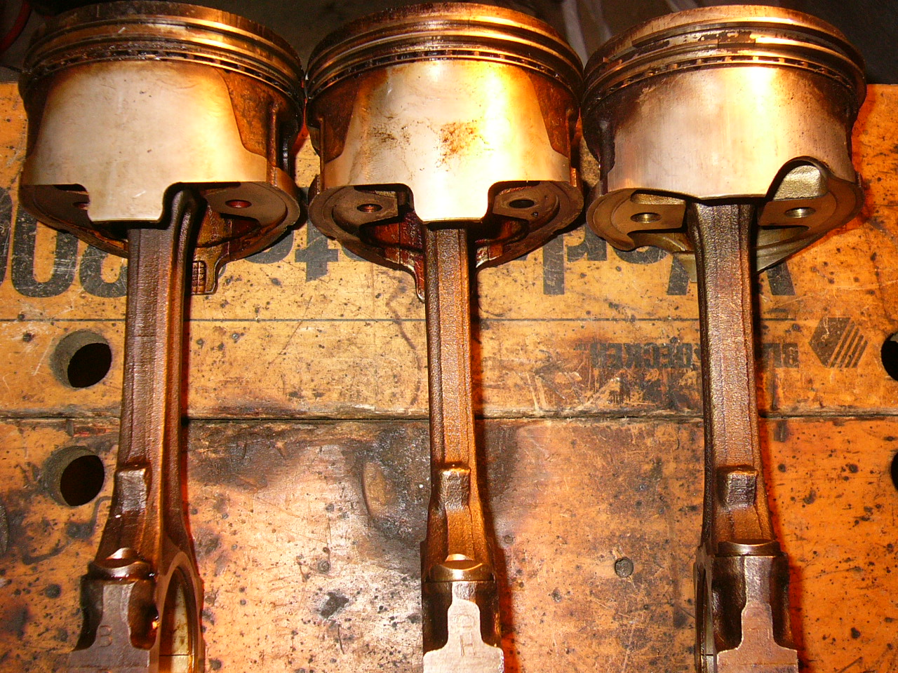

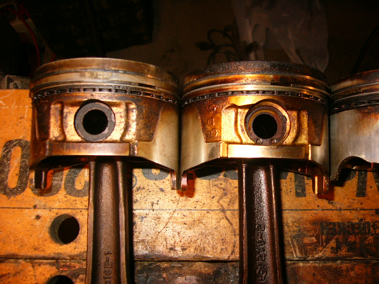

mtcookson Posted March 2, 2006 Author Share Posted March 2, 2006 Pictures! Left to right: 84-86 VG30ET, 89-94 Maxima VG30E, 90-96 300ZX VG30DETT Left: 84-86 300ZX VG30ET Right: 89-94 Maxima VG30E Left: 89-94 Maxima VG30E Right: 90-96 300ZX VG30DETT In these pictures the angles screw up the way the rods look. The Maxima rod looks the thinnest of all of them however it is the same thickness as the VG30ET rod (left). Left: 84-86 300ZX VG30ET Right: 89-94 Maxima VG30E Left: 89-94 Maxima VG30E Right: 90-96 300ZX VG30DETT Left to right: Z32, Maxima, Z31 (Yes... that piston from the VG30ET is scored all over. There is even a small chunk missing out of the side of it. Whoever messed with that engine before we got the car had no idea what they were doing... that thing was in such bad condition that I'm having to put in a totally different engine. I'm thinking they tried turning up the boost without adding any fuel and/or an aftercoole. There's a manual boost control in the car... yes in the car... without any supporting mods, so I'm guessing they definitely had no idea what they were doing.) Higher resolution: http://www.machzracing.com/pictures/vginternals1.jpg http://www.machzracing.com/pictures/vginternals2.jpg http://www.machzracing.com/pictures/vginternals3.jpg http://www.machzracing.com/pictures/vginternals4.jpg http://www.machzracing.com/pictures/vginternals5.jpg http://www.machzracing.com/pictures/vginternals6.jpg http://www.machzracing.com/pictures/vginternals7.jpg http://www.machzracing.com/pictures/vginternals8.jpg http://www.machzracing.com/pictures/vginternals9.jpg http://www.machzracing.com/pictures/vginternals10.jpg http://www.machzracing.com/pictures/vginternals11.jpg Quote Link to comment Share on other sites More sharing options...
desert dog Posted March 2, 2006 Share Posted March 2, 2006 The VG30DETT rods are beefy. Especially after comparing it and the pistons to other VG30 components. The crank end of the Maxima rod looks to be substantial as well. From what I have read the VG30DETT rods are the same as the VG30DE's... Nice pics... Quote Link to comment Share on other sites More sharing options...
mtcookson Posted March 2, 2006 Author Share Posted March 2, 2006 Yeah, VG30DETT and VG30DE rods are the same... actually I think the VE30DE has the same rods as those as well. Quote Link to comment Share on other sites More sharing options...
Beck Posted March 2, 2006 Share Posted March 2, 2006 VG30DETT VG30DE VE30DE Same rods, exact same part number in US. Quote Link to comment Share on other sites More sharing options...
