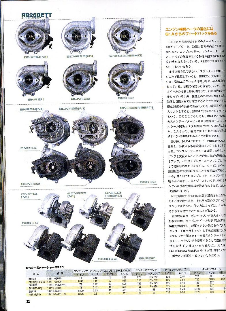

HakosukaJD Posted June 5, 2006 Share Posted June 5, 2006 Tad bit grainy at the expense of size...but I can upload a clean image to photobucket if you like.... Quote Link to comment Share on other sites More sharing options...
Z24O Posted June 10, 2006 Share Posted June 10, 2006 that would be appreciated Tad bit grainy at the expense of size...but I can upload a clean image to photobucket if you like.... Quote Link to comment Share on other sites More sharing options...
