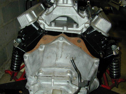

In case it is not clear to most, GM trannies have 2 different bolt patterns referred to the Chevy and the BOP (Buick-Olds-Pontiac). Obviously the T56 would bolt right up to the cylinder-challenged SBC :D :D and the Buick V6 would need an adaptor like the one in the pic.
