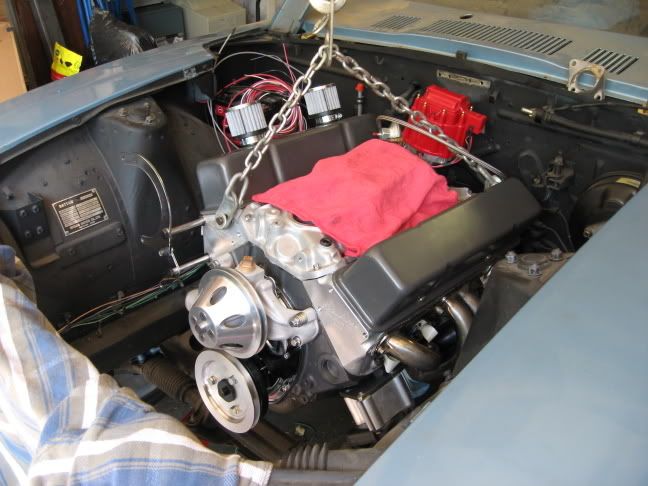

BillZ260 Posted June 27, 2006 Author Share Posted June 27, 2006 Ok so here's the short version... Finished up HTOB plumbing!! Kicked A$$!! She's in!! Here's the rest of the story, took us about an hour and a half to get it lined up so we could get the bolts started through the mounts. I didn't slot my holes, didn't like the thought of it so it took a while but everything is square now http://img.photobucket.com/albums/v469/billz260/IMG_0009.jpg http://img.photobucket.com/albums/v469/billz260/IMG_0012.jpg http://img.photobucket.com/albums/v469/billz260/IMG_0017.jpg http://img.photobucket.com/albums/v469/billz260/IMG_0022-1.jpg Quote Link to comment Share on other sites More sharing options...

DavyZ Posted June 28, 2006 Share Posted June 28, 2006 Greta photos of the progress coming along nicely. BTW, the wife thinks the wine & Fresca will taste like a Sangria of sorts. I still need to gsather the cajones and buy some Fresca to mix with. Wine I have, Fresca no. Please post your thoughts and experience with the HTOB and how well you think it works. I have the same bellhousing (I also have the Corvette bellhousing) and I'm not sure what I want: hydraulic or mechanical. I'm not sure which is "best" or if it really matters. Ah, trying to decide. Also, what brand is the clutch you are using? Specs? Cost? I have the Camaro 5 speed, which is what you have. BTW, good color scheme for the engine & bay... Davy Quote Link to comment Share on other sites More sharing options...

BillZ260 Posted June 28, 2006 Author Share Posted June 28, 2006 1. Please post your thoughts and experience with the HTOB and how well you think it works. I have the same bellhousing (I also have the Corvette bellhousing) and I'm not sure what I want: hydraulic or mechanical. I'm not sure which is "best" or if it really matters. Ah' date=' trying to decide. 2. Also, what brand is the clutch you are using? Specs? Cost? I have the Camaro 5 speed, which is what you have. 3. BTW, good color scheme for the engine & bay... Davy[/quote'] 1. The Tilton HTOB I got is very nice, servicible and easy (fairly) to set up. There are two parts to it. The base, which replaces the front bearing retainer on the T5 which is threaded. And the actual unit that threads on to the base. You basically take the measurement from your Pressure Plate teeth (w/ clutch disk installed!) to the face of the bellhousing (trans not installed) Take that subtract 1/8" and make sure the HTOB bearing face is that far off the face of the trans. I'll let you know how it performs when i get the car running. (I also bought a new Tilton Master Cyl) 2. The clutch I got was the RAM 10.5" 'stock replacment' clutch disk and pressure plate. I aslo bought their billit flywheel to match. Total cost w/ the flywheel was high, I chose this brand because Mike Kelly suggested it in another thread. Clutch Disk ~$150, Pressure Plate ~$150 (machine shop said it was PERFECTLY ballanced) and the Billit 153 tooth flywheel was $245 w/ the ARP Crank and Pressure plate bolt kits. OUCH, but it nice! 3. Thanks! I'm going for subdle and clean. Shades of grey and metal seem to work pretty well so far. I think I'll paint the chrome alt bracket (the alt is black) and thinking maybe some Grey wire loom, or do you think black would be better? JT1 - I'll definitly secure the lines! Thanks! Quote Link to comment Share on other sites More sharing options...
