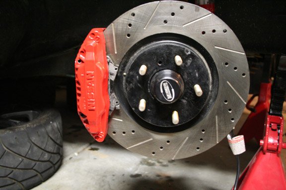

  7. Just to clarify. I designed my kit with with the MM hubs that were +3/4 offset. I had a bearing fail and one of my hubs was damaged. Ross inspected it and sent me a steel Z31 hub. He didn't have any more production hubs in stock and I didn't feel like buying another one so I swapped my out to the steel Z31 pentagon hubs with the +3/4 offset. The bracket I made all bolts up the same. I do not have a drawing of the bracket I made. Remember mine was for the Z32 caliper on Z33 track rotors. If there is enough interest I will make a production quality run of mine rather than the rough one I did. If you want to talk more in detail send me a PM since I don't want to highjack the original posters thread, unless they want more specifics on what I did. thanks.
  8. I was really just answering the basic question that yes you can use a Z31 hub on a S30 spindle. There are a million posts on this out there already. Yes, that pic is of Ross's hub. I am not using the hubs from Modern Motorsports as this is an older pic. I am using the Z31 +3/4 offset pentagon hubs. Mine is not a kit it is all custom. If you want to see more of mine check out my album but it is not necessary relevant to the original poster as he is interested in Z31 calipers not Z32 calipers on Z33 track rotors.
  9. Pictures always help. This is a Z31 hub on an S30 spindle. I used Z32 calipers and Z33 track rotors. I had to make an adaptor. For the rear you have multiple options. The one I opted for was to use the rear Z31 stub axle in a 280Z rear housing (had it bored out for Z31 bearings) and used the Z31 flange for the CV axles. I thought someone on this board claimed to have the bearings to do this swap without any of the machining I had done. You might want to search. Again, this was the route I choose there are several other methods to get the 5 lug setup.
