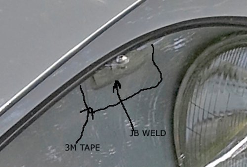

cygnusx1 Posted September 21, 2006 Share Posted September 21, 2006 MY OFFICIAL POST # 1 0 0 0 It takes some finesse to get them right. I lay down a strip of clear "stone gaurd" tape in the general location of the bracket. Then I use epoxy or JB Weld to glue the brackets onto the tape. I set them back from the edge about 1/4" so that I have the ability to "pull" the headlight cover in with the screws to get the right depth for proper alignment. No drilling and to remove the brackets, you can peel off the "stone gaurd" tape. It saves the paint too. Quote Link to comment Share on other sites More sharing options...

cygnusx1 Posted September 22, 2006 Share Posted September 22, 2006 You are close. It it made by 3M but it is really tough and it sticks like glue. http://www.xpel.com/products/bulk.asp I use this stuff on my lower front fenders, on the front of the rear flare, and on part of the rockers. It is clear, damn near invisible and stops chips. Buy it in bulk. Cut it to fit. Stick it on. Basically you make some 2" x 1" patches of it and stick it on the headlight buckets in three spots where you would normally drill mount the L-brackets. Then you glue the L brackets on top of this tape. That way you are not drilling into the car and you are not gluing the L-brackets onto your paint. Use JB Weld to glue the L-brackets onto the tape patches. You can move them around to get the location perfect before the JB Weld hardens. Quote Link to comment Share on other sites More sharing options...

qwik240z Posted September 22, 2006 Share Posted September 22, 2006 You are close. It it made by 3M but it is really tough and it sticks like glue. http://www.xpel.com/products/bulk.asp I use this stuff on my lower front fenders, on the front of the rear flare, and on part of the rockers. It is clear, damn near invisible and stops chips. Buy it in bulk. Cut it to fit. Stick it on. Basically you make some 2" x 1" patches of it and stick it on the headlight buckets in three spots where you would normally drill mount the L-brackets. Then you glue the L brackets on top of this tape. That way you are not drilling into the car and you are not gluing the L-brackets onto your paint. Use JB Weld to glue the L-brackets onto the tape patches. You can move them around to get the location perfect before the JB Weld hardens. I also didn't want to drill into the buckets. Any chance of seeing a closeup of the L brackets mounted? Thanks! Quote Link to comment Share on other sites More sharing options...

cygnusx1 Posted September 22, 2006 Share Posted September 22, 2006 Lemme see if I can pull up a closeup from some old photos. If not, I will take a photo tonight. Quote Link to comment Share on other sites More sharing options...
cygnusx1 Posted September 22, 2006 Share Posted September 22, 2006 See Attached: Quote Link to comment Share on other sites More sharing options...
