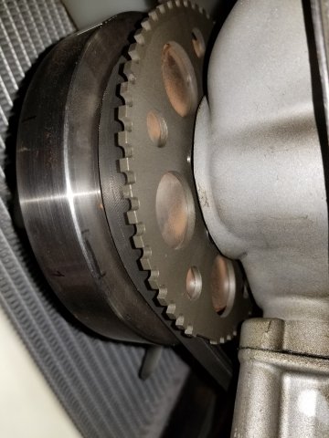

I know this is an old thread but I am in a similar position to George. I have one of these BHJ dampers and want to fit a trigger wheel to it. When the damper is installed on the engine there doesn't appear to be enough space between the damper and timing cover. The wheel I have is not the one from BHJ and is the standard 5mm thick but I think the gap looks to be less than 5mm. How did you get on George?

I have a BHJ dampener with a trigger wheel for an Electromotive ignition system with sufficient clearance. My set up uses flat head screws and a 3mm thick trigger wheel.
Countersink you trigger wheel and use flat head screws, The head of the screw should be flush with the back side of the trigger wheel. Looking at my car I think your 5mm thick trigger wheel will fit.
If your BHJ dampener uses Imperial-inch threads to attach the trigger wheel you will need to use an 82 degree countersink if it has metric threads you will need to use an 90 degree countersink this is important.
Not the best picture Zoom in to see flat head screw.
