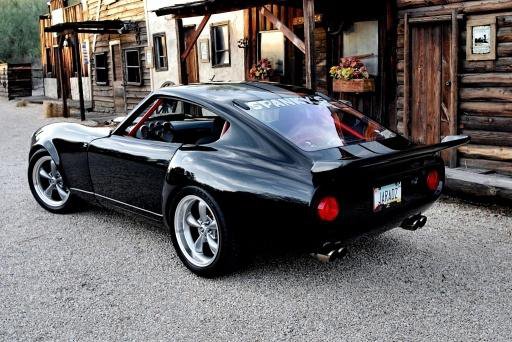

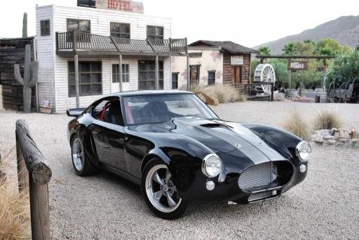

Fauxre Posted September 22, 2012 Share Posted September 22, 2012 (edited) ok thanks. was thinking of a thinner wheel up front, but it is hard to find off the shelf wheels that have a 6-6.5" front matched with a 8-8.5" rear, even when staggered . These Rotas were the only off the shelf wheels I found with the stock Z bolt pattern, back spacing and widths I was looking for. They also had a nice price. Originally I was looking at custom rims from Boze. Nice, but expensive. Edited September 22, 2012 by Fauxre Quote Link to comment Share on other sites More sharing options...

Fauxre Posted October 4, 2012 Share Posted October 4, 2012 (edited) I forgot to ask. What offset did you use? Back spacing for both wheels is 4.5 in. That makes the front offset -13mm and the back -19mm. This pic has all the dimensions and compares both wheels and tires. And I used a 2" spacer on the rear and a 1" spacer up front. Needed the rear spacer to fill the fender well. I needed the front spacer only because the center cap would not snap on over the Datsun dust cap. Edited October 4, 2012 by Fauxre Quote Link to comment Share on other sites More sharing options...

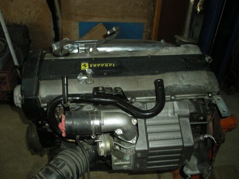

Fauxre Posted October 4, 2012 Share Posted October 4, 2012 Here are a few in process picture of my GTO project. http://s24.photobuck...ull/Datsun-GTO/ Looks like you're well on your way! And a nice shop to work in as well. I'm not very engine savvy... is this the RB25DET engine with a prancing stallion engine cover? Quote Link to comment Share on other sites More sharing options...
Kclank Posted October 4, 2012 Share Posted October 4, 2012 Looks like you're well on your way! And a nice shop to work in as well. I'm not very engine savvy... is this the RB25DET engine with a prancing stallion engine cover? Yes, it is a bit of hubris. Quote Link to comment Share on other sites More sharing options...

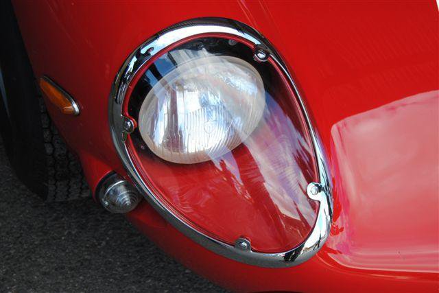

mono Posted December 20, 2012 Share Posted December 20, 2012 (edited) Need a source for headlight cover metal trim rings (Alpha GTO replica). Edited December 21, 2012 by mono Quote Link to comment Share on other sites More sharing options...

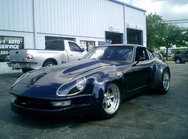

Uglyeddie Posted December 31, 2012 Share Posted December 31, 2012 Hey all: Been a while since I've been on the boards, computer crashed, can't remember passwords, life gets in the way, etc. I'm starting to buy up some parts for the spring rejuvenation of my 240. Here's the deal: I've never been comfortable telling people it's a Ferrrari when they ask, ( took the Ferrari badges off almost as soon as I put them on.)and the only person I think I ever fooled was a blonde gal. (Nothing personal, Chelle... lol) Besides, nobody who knows cars believes they are seeing a 15 million dollar car in the Wal-Mart parking lot. What I'm thinking of doing is putting a stock 240z front clip back on, leaving the wide-body rear and doors, painting it Matte Silk Black, slamming it down to the ground and messing around with a huge tail fin, something like a RWB Porsche. Does anyone have pics of their build with the stock Z front clip and the 250 rear clip attached? I don't have the original parts so I'm going to have to buy a donor car and don't want to spend the money on it if someone else has already done this and knows if it will work or just look goofy.... maybe some front fenders from Subtle Z? Thanks Quote Link to comment Share on other sites More sharing options...
Fauxre Posted December 31, 2012 Share Posted December 31, 2012 Need a source for headlight cover metal trim rings (Alpha GTO replica). I'm not aware of any one manufacturing the trim rings. If you read through this thread, I think you'll find that most were home made or done by a local shop. Quote Link to comment Share on other sites More sharing options...

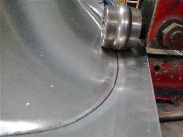

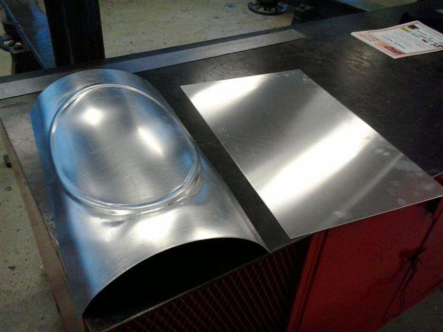

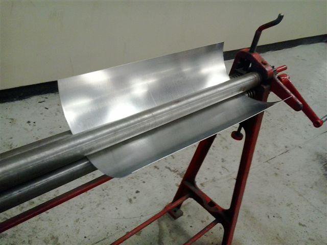

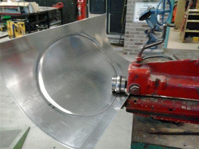

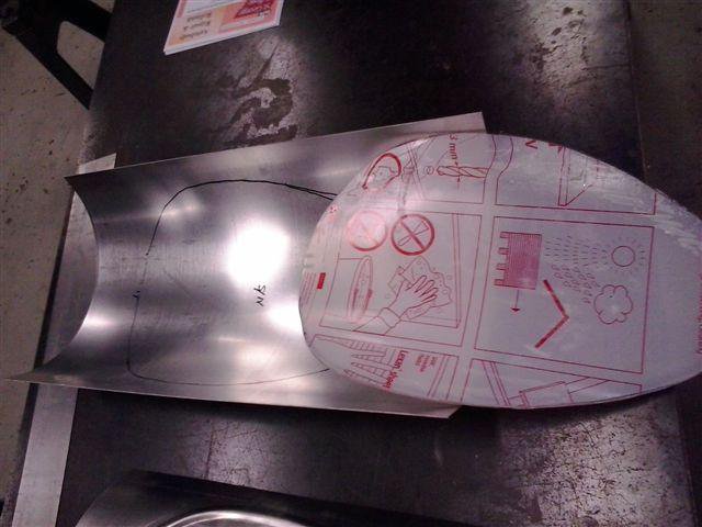

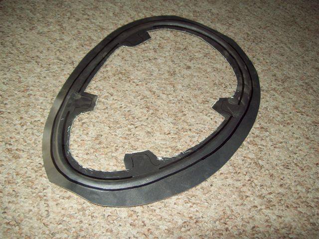

Boy from Oz Posted January 2, 2013 Share Posted January 2, 2013 (edited) Need a source for headlight cover metal trim rings (Alpha GTO replica). I thought ThunderRanch had them but here is how I made them. Any sheetmetal fabrication shop should be able to made them for you. You need the lexan covers to use as a template. 1 Curve the sheet (I used aluminium) (edit). 1.0mm thickness. 2 Use the headlight cover to mark the centreline. 3 Use a swage tool to create the dome form 4 Mark out the securing tab locations. 5 Cut out. 6.Carefully trim Edited January 4, 2013 by Boy from Oz Quote Link to comment Share on other sites More sharing options...
