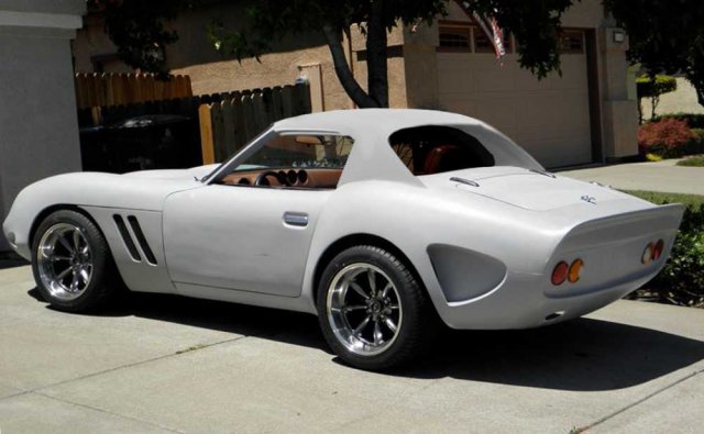

Fauxre Posted April 25, 2013 Share Posted April 25, 2013 I'm considering building a removable hardtop for those rainy days. Using the #8 GTO for inspiration.... Mine might look something like this. Quote Link to comment Share on other sites More sharing options...
Boy from Oz Posted April 25, 2013 Share Posted April 25, 2013 Or you could do a ragtop. Quote Link to comment Share on other sites More sharing options...
Fauxre Posted April 25, 2013 Share Posted April 25, 2013 (edited) I've considered a soft top, but I'm not crazy about the bulk it creates behind the seat when down...at least the ones I've seen so far. And I'm not sure I can fit one around the rollbar I'm using. And this pic actually looks like a solid top to me. Edited April 25, 2013 by Fauxre Quote Link to comment Share on other sites More sharing options...
Boy from Oz Posted April 26, 2013 Share Posted April 26, 2013 On 4/25/2013 at 4:53 PM, Fauxre said: ...And this pic actually looks like a solid top to me. Quote Link to comment Share on other sites More sharing options...
Kclank Posted April 28, 2013 Share Posted April 28, 2013 i like it. go for it! Quote Link to comment Share on other sites More sharing options...

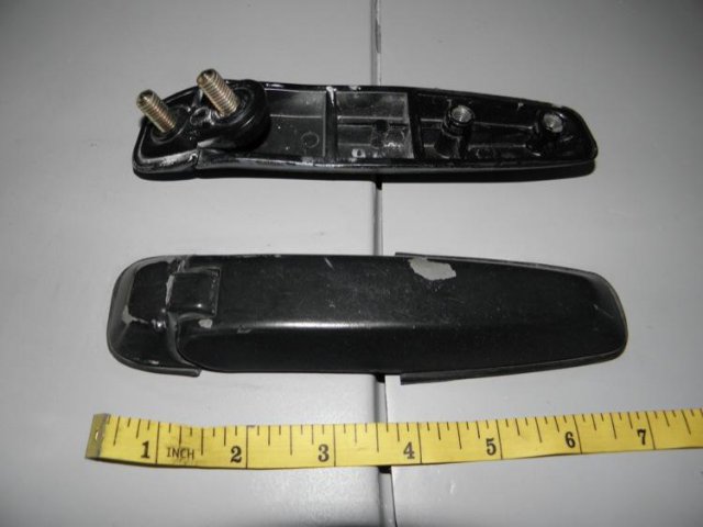

TomoHawk Posted May 2, 2013 Share Posted May 2, 2013 Where did you get the outside door handles? Quote Link to comment Share on other sites More sharing options...

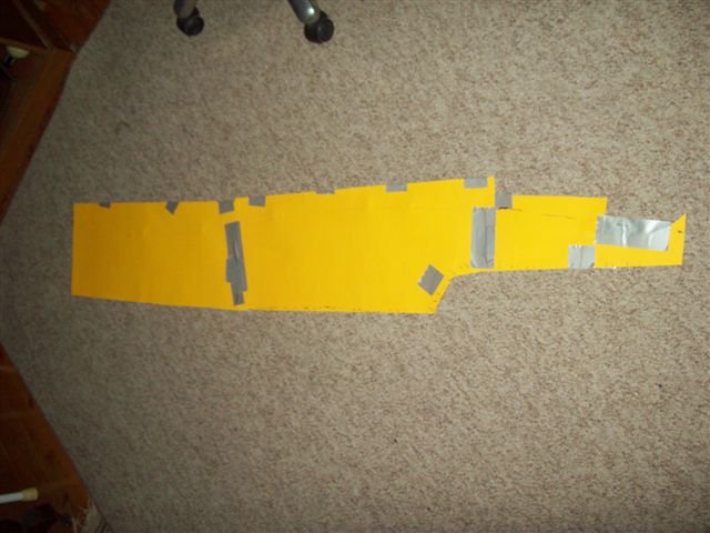

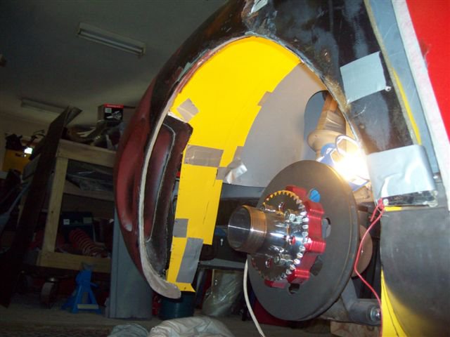

TomoHawk Posted May 2, 2013 Share Posted May 2, 2013 When you cut the body over the rear wheels, so you have to use the 'supplied emplate?' I didn't get a template. Instead I got some sketches showing a cross-section of the metal in the area and a note saying to just cut the body to be even with the top of the wheel well, then cut the slots to bring the metal out to the outer body for welding. You could easily make a mess of the opening, unless you had a good eye for curves. I'm not even sure what kind of material the wheel well template was made of. It could be card, paper, or something with adhesive? Can anyone suggest a supplier of the template, or make a copy of the template? Quote Link to comment Share on other sites More sharing options...

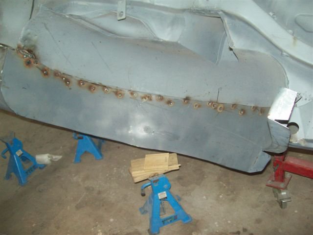

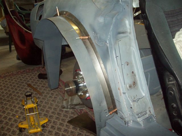

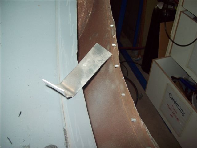

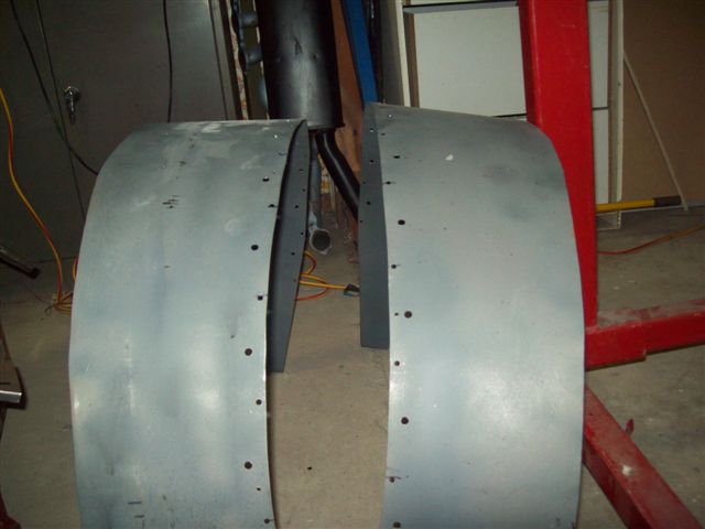

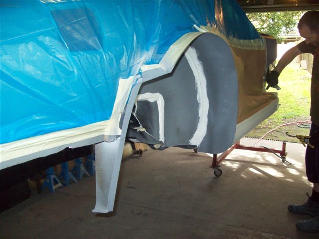

Boy from Oz Posted May 2, 2013 Share Posted May 2, 2013 (edited) On 5/2/2013 at 3:00 AM, TomoHawk said: Where did you get the outside door handles? That's not my car, sorry I can't help On 5/2/2013 at 3:45 AM, TomoHawk said: ...Can anyone suggest a supplier of the template, or make a copy of the template? There was no template with my second-hand Puckett kit but here's how I went about it. There would be no point in using a Puckett template unless you had a Puckett. The process outlined below could be followed for any kit - I think! I marked out and cut the tub 50mm from the centre join line. I used a bit of 'L' shaped scrap metal to scribe a line on the inside of the quarter panel, parallel to the arch of the tub. I cut the quarter panel along the line. I temporarily located the fibreglass rear section.in position. I cut a cardboard template to the shape of a new tub. I made a strip of sheet steel to the shape of the template and drilled welding holes and then curved it by hand - not hard. I fitted the new tub extension and welded it in position via the pre-drilled holes. I am in the process of attaching vertical sheet metal panels to the tubs which will provide a surface which will glue to the fibreglass section on final installation. I did most of the work whilst the car was on a rotisserie so some of the images may appear upside-down - but that's what we Downunder are used to! Edited May 2, 2013 by Boy from Oz Quote Link to comment Share on other sites More sharing options...

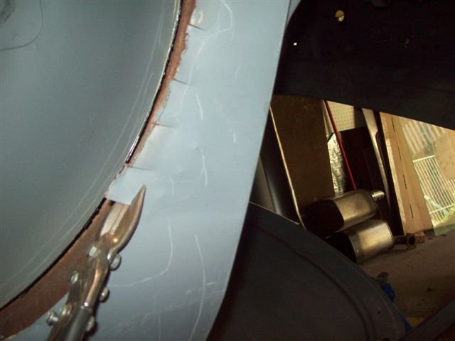

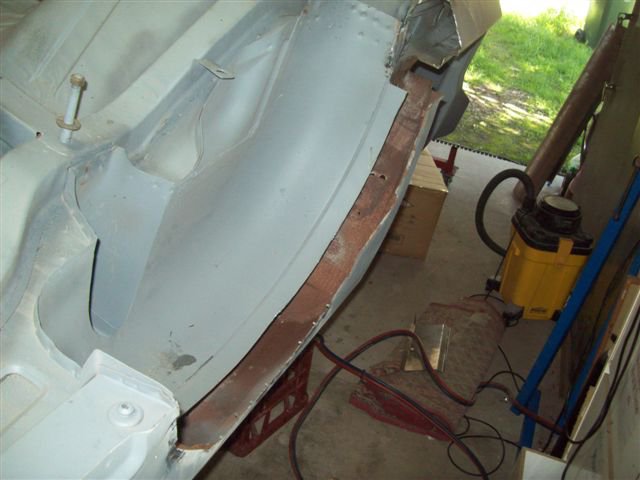

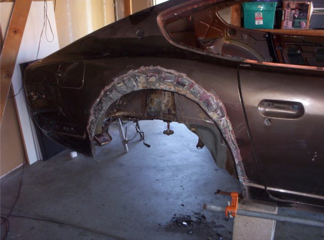

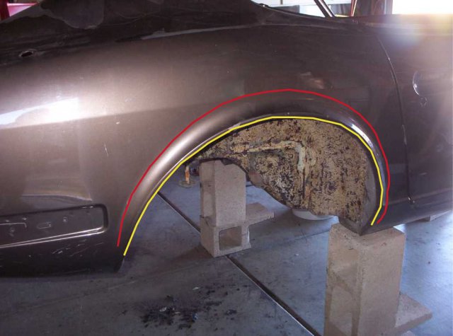

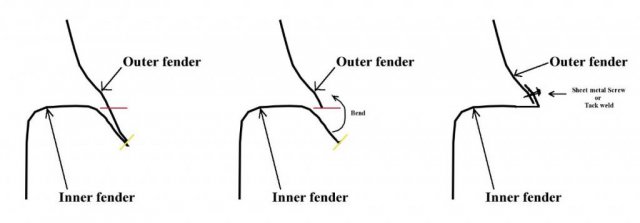

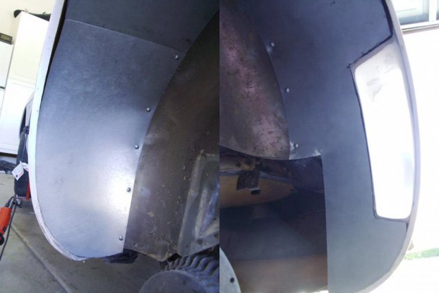

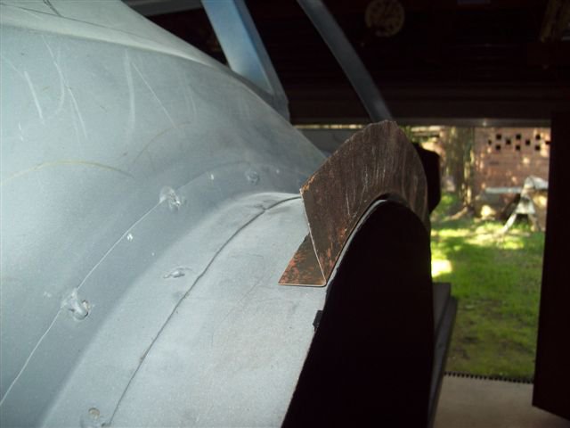

Fauxre Posted May 2, 2013 Share Posted May 2, 2013 Very elegant BFO. My method is a lot uglier. Using the directions in my VR manual (no template included), I first cut along the yellow line to separate the outer and inner fenders, then along the red line only through the outer sheet metal. The red line in the photo is even with the highest point of the inner fender all the way around like in this diagram. The inner fender is then cut into tabs and and each tab is folded up over the outer sheet metal. I tack welded them, but I've seen sheet metal screws used to secure the tabs as well. Once the rear tub was mounted and the vents complete. I cut sheet metal to extend the inner fenders out to the tub, covering all the tabs. They're attached with sheet metal screws so I can access the closed off area if I need to later. It's not pretty, but it still does the job. Hope this helps. Quote Link to comment Share on other sites More sharing options...
Boy from Oz Posted May 2, 2013 Share Posted May 2, 2013 Excellent, Wes. Wish I knew that before i started. If there is an overcomplicated way of doing something, fear not, I will find it! Quote Link to comment Share on other sites More sharing options...
