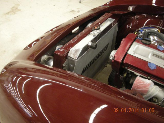

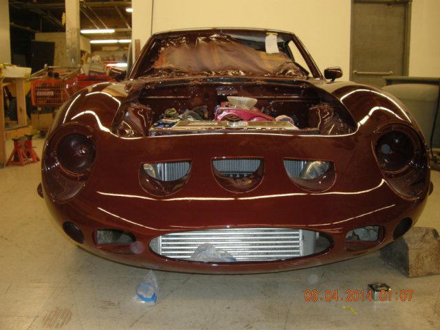

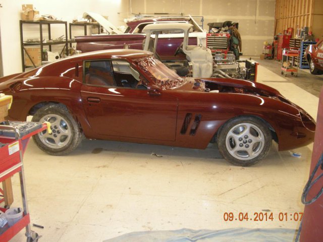

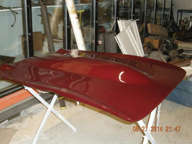

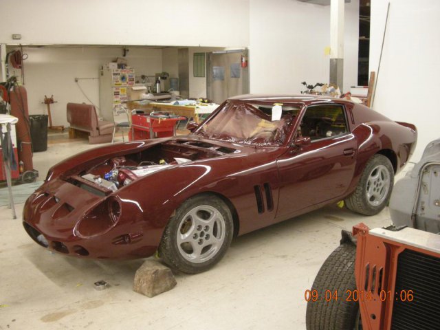

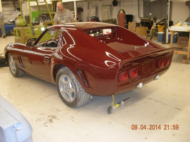

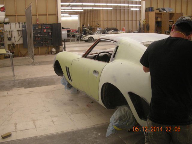

Kclank Posted August 22, 2014 Share Posted August 22, 2014 (edited) The project is moving along. Fresh from the paint booth this morning. The pictures do not do it justice. Up close this fiberglass looks as straight as metal where a lot of Fiberglas bodies tend to be wavy. Thumbs up to Ancient Auto body and a fantastic team of anal retentive technicians (in a good way) who have taken this project as if it was their own. Lot's more to do, but the engine should be in soon so the car can begin to sit as it should. More to follow as the build continues. Doors and hood are in wet sanding now and will probably be painted today. sorry the picture files became corrupted and i did not have backups. Edited September 18, 2014 by Kclank Quote Link to comment Share on other sites More sharing options...
SpeedRacer Posted August 22, 2014 Share Posted August 22, 2014 Wow!!! What a gorgeous color and boy does it look smoooooth!!!! Yeah, it takes many, many hours of sanding, guide coating, sanding, guide coating, sanding, etc. to get the panels to look like metal but it is really worth it in the end. Please keep us updated as I can not wait to see the finished product. Quote Link to comment Share on other sites More sharing options...

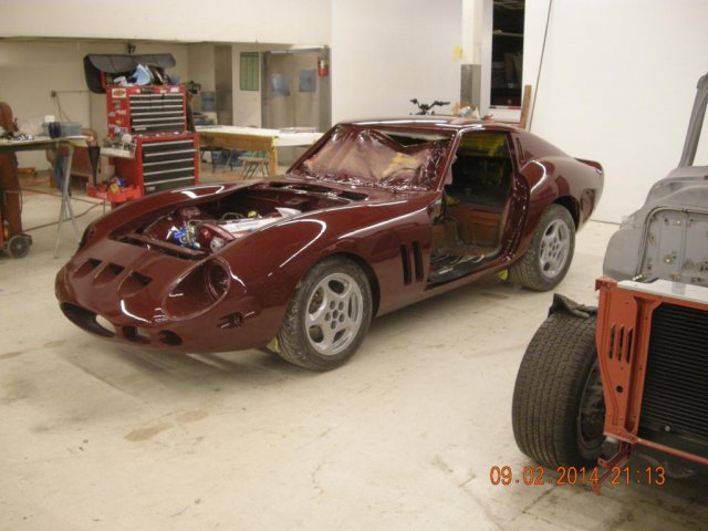

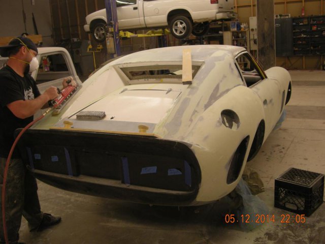

Tokyo Drftr Posted August 26, 2014 Share Posted August 26, 2014 here"s the KC(s) mounted Quote Link to comment Share on other sites More sharing options...

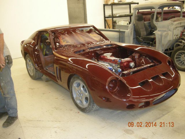

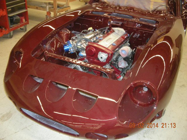

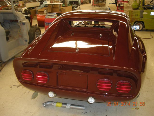

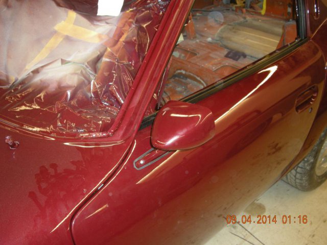

Kclank Posted September 6, 2014 Share Posted September 6, 2014 A few updates for my project car. The intercooler is just sitting there not in final position. Quote Link to comment Share on other sites More sharing options...

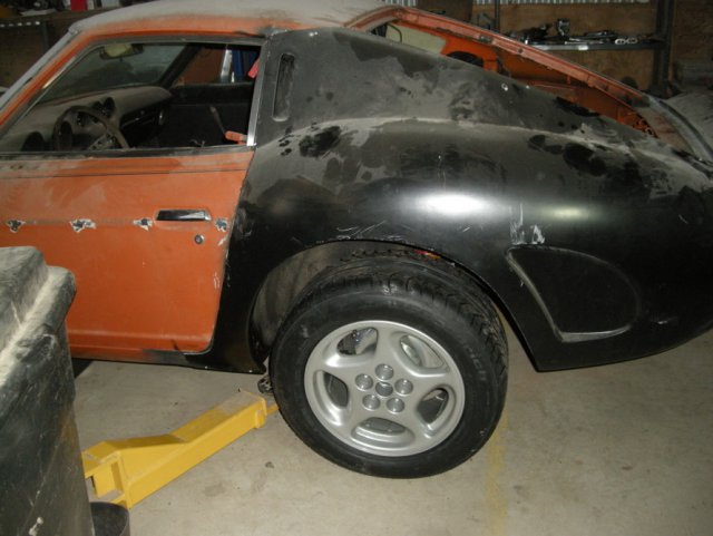

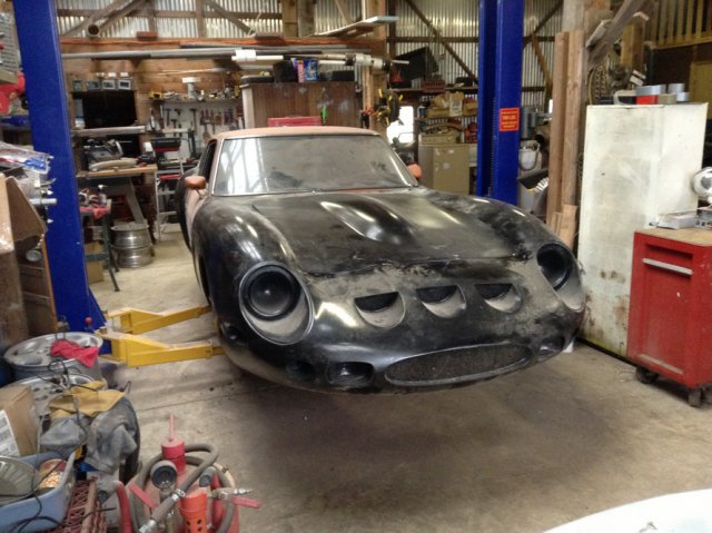

TomoHawk Posted September 17, 2014 Share Posted September 17, 2014 (edited) I would like to ask if anyone would please submit a few photos of the conversion process, so I could 'sell the idea' to a friend that's interested in helping me out. Maybe we could build two! Photos: front clip installed Rear clip installed door skins installed hood hinges attached to chassis THanks! Edited September 17, 2014 by TomoHawk Quote Link to comment Share on other sites More sharing options...
Boy from Oz Posted September 17, 2014 Share Posted September 17, 2014 If you send me a message with your email address I send you a copy of the installation guide. It's very old, probably for an Alpha version. Quote Link to comment Share on other sites More sharing options...
Kclank Posted September 17, 2014 Share Posted September 17, 2014 (edited) I would like to ask if anyone would please submit a few photos of the conversion process, so I could 'sell the idea' to a friend that's interested in helping me out. Maybe we could build two! Photos: front clip installed Rear clip installed door skins installed hood hinges attached to chassis THanks! I can send you pics of these items after they have been installed, but i do not have the details of alignments and trial fitting. I have the installation manual from John Washington's VR and I could give/send you and I have a copy of what was Thunder Ranch's 250 GTO manual which is attached in PDF format. The VR manual is more detailed and the better guide but I would offer that if you want a real nice car that you have or can obtain professional auto body technician skills. INHO a layman with good mechanical ability and the ability to work with fiberglass and auto body fillers can do it but it will take a lot longer to obtain nice results (a bazzilion hours of sanding, filling, etc). If you are building a racer or just a toy, and don't require a showy fit and finish then it probably be thrown together in 100-150 hours (not counting mechanical work on the car). Its the final finish that takes much more time. The VR has a nice option for the tilt front end like a corvette or XKE. I am using the fixed front with normal hood opening. I have a few pics in this thread and lots of other folks do also. if you want the documentation I offered PM me with your address. I do not want to scan and send. In all honesty the only thing in the manual(s) that did me any good was methods of bonding and filling and the cutting out of the rear wheel well lips. Other then that it is more of fit, trim/fill, sand, fit, etc intil you are saticfied. Most of this is on the front end, and substantially on the door skins.. the rear clip (TR kit) was a pretty good fit for contour and only required moderate fitting. of course you have to decide on lights which to need to layout for position and trim. The front clip takes a lot of fitting not because the kit front ends are bad, but more because of variations in the 240/260/280 chassis around the cowl and front edges of doors. Hood hinges are dependent on which type of front end you choose. In theory you use the stock front fender fastener locations for the fixed front but transferring the hole pattern is problematic. i had mine bonded on by the shop that has done much of my body work. I used a Pantera style hatch instead of the stock Datsun hatch so I have no experience with the stock hatch fitment to the new aft skin. My biggest issue was locating window/door seals that fit since new replacements are either thicker or harder so getting the seals to relax properly takes some time with heat. The upper window seals have a wiper lip that is hardest to replace. Save all old parts until to are finished reassembling. Even old dried seals can often be reinvigorated by soaking in silicon oils. Door hinges stay in factory locations and do not change due to kit however shimming may be necessary to help alignment to fit gaps to front fenders and rear clip. It's an interesting journey so hang in there thru any frustrating times. Lots of help and suggestions on this site and a bit on "Mad Mechanics". Keep a positive attitude and have fun. Hope what I am sending helps ya. GTO PAGE 1.pdf GTO PAGE 2 PARTS PACKING LIST.pdf 250 Manual.pdf Weatherstrip1.pdf Edited September 27, 2014 by Kclank Quote Link to comment Share on other sites More sharing options...
