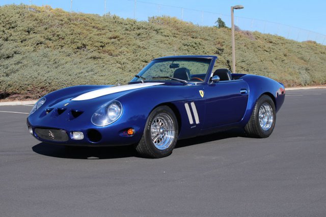

Fauxre Posted December 16, 2014 Share Posted December 16, 2014 I would like to ask if anyone would please submit a few photos of the conversion process, so I could 'sell the idea' to a friend that's interested in helping me out. Maybe we could build two! Photos: front clip installed Rear clip installed door skins installed hood hinges attached to chassis THanks! Hey TomoHawk, Not sure how I missed this post. I know you you're not building a roadster like mine, but I have quite a few photos on my VR build thread (http://forums.hybridz.org/topic/85830-vacaville-velo-rossa/ )that might give your friend the general scope of the whole project. Hope this helps. Quote Link to comment Share on other sites More sharing options...

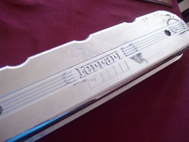

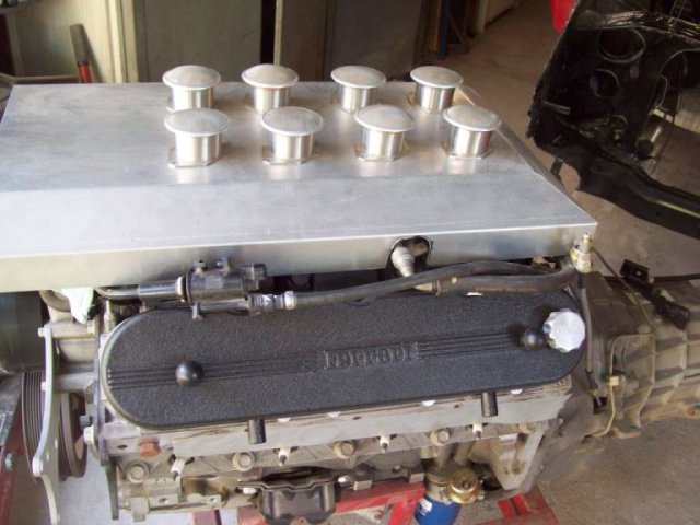

TomoHawk Posted December 22, 2014 Share Posted December 22, 2014 I saw a photo of a Datsun valve cover that was modified to resemble a Ferrari valve cover with black wrinkle paint and a Ferrari logo. Has anyone seen it, or have any ideas how you could do all that? The black wrinkle paint sounds easy, but what about the lettering? IMO< t would probably need to be cut but of thin plastic (heat-resistant) or metal glued to the paint. Quote Link to comment Share on other sites More sharing options...
Boy from Oz Posted December 22, 2014 Share Posted December 22, 2014 It would depend on how far you want to go and what sort of appearance you are after. An important factor of early Ferrari valve covers is their simplicity - they were racing cars in those days not the the display of opulence of today. Apart from the Ferrari name the series of parallel ridges is just as significant. I'm not all that familiar with a Z valve cover but here is how I would probably go about it. - Have a machine shop mill the top of a cover removing any raised sections and ensuring there is a flat section 1" wide along the center. You could even do it yourself with a hand grinder. - Obtain a strip of aluminium flat bar (1" x 1/4") to fit along the top. - Drill three holes (about 1/2") through the cover where the aluminium is resting. - Weld the aluminium bar to the valve cover from inside ensuring the weld seals the holes. - Have an industrial engraver create the Ferrari logo and grooves. - Finally, POWDER COAT. Do not paint as powder coating looks 10 times better and you will lose the details of the engraving if you use paint. I was able to engrave directly into the valve cover but the outcome should be the same Quote Link to comment Share on other sites More sharing options...

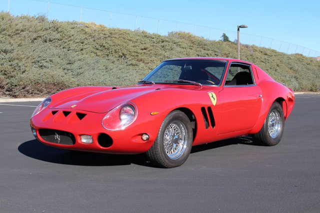

Fauxre Posted January 21, 2015 Share Posted January 21, 2015 (edited) Found these two at a local consignment dealer. http://www.specialtysales.com/vehicles/11090 http://www.specialtysales.com/vehicles/11089 Both would make nice daily drivers or weekend drivers, but IMHO, the owner has them priced like show cars. Too many flaws to list. The Velo Rossa's bonnet fits worse than mine. I hope he gets what he's asking for them. A rising tide lifts all boats. Edited January 23, 2015 by Fauxre 1 Quote Link to comment Share on other sites More sharing options...

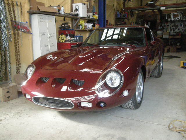

Kclank Posted February 27, 2015 Share Posted February 27, 2015 My project is now back from the body shop. Next job is pumbing brakes, clutch, and fuel lines. Quote Link to comment Share on other sites More sharing options...
SpeedRacer Posted February 28, 2015 Share Posted February 28, 2015 (edited) Wow, talk about lifting all boats - how about a "By It Now" of $140,000!!!!!! http://www.ebay.com/itm/400873630999?_trksid=p2060778.m1438.l2649&ssPageName=STRK%3AMEBIDX%3AIT If they get anywhere north of $50,000 I might just have to sell. Update: Wow it got up to $74,011.00 but didn't meet the reserve. Edited March 12, 2015 by SpeedRacer Quote Link to comment Share on other sites More sharing options...

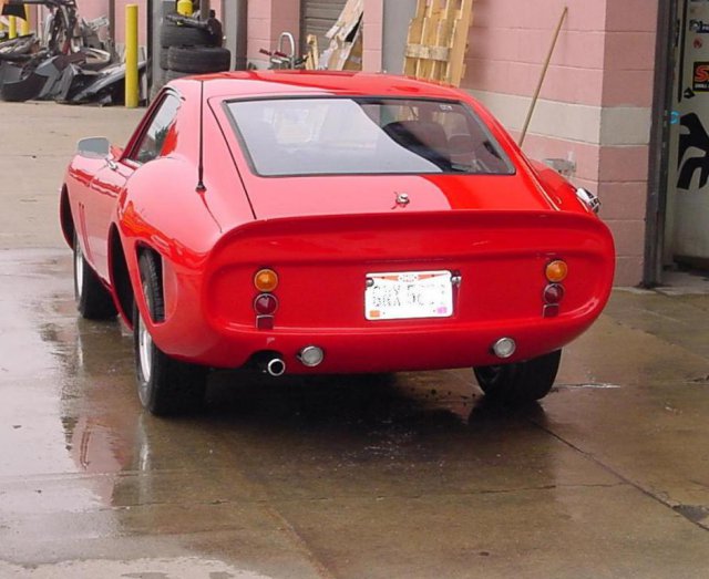

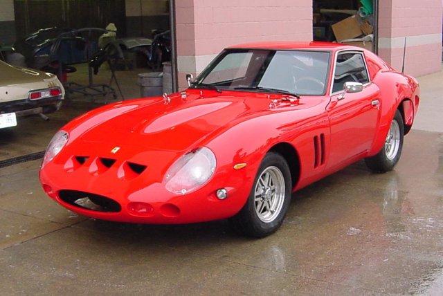

SpeedRacer Posted March 12, 2015 Share Posted March 12, 2015 (edited) Here is another pretty good looking Ferrari GTO replica listed on eBay. http://www.ebay.com/itm/111617495043?_trksid=p2060778.m1438.l2649&ssPageName=STRK%3AMEBIDX%3AIT Edited March 12, 2015 by SpeedRacer Quote Link to comment Share on other sites More sharing options...

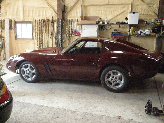

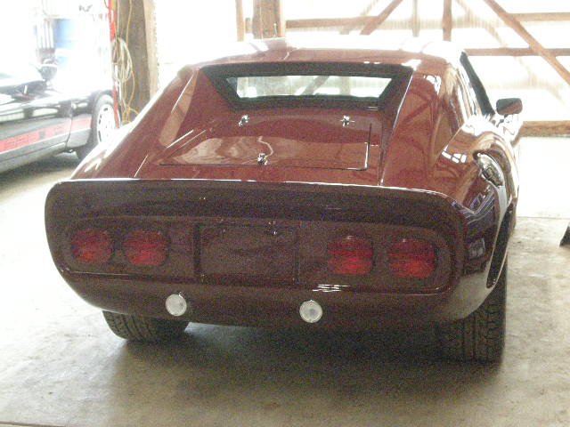

TomoHawk Posted July 12, 2015 Share Posted July 12, 2015 (edited) I think mine is finally done? Mine has totally stock Zed equipment. I think I will add a diamond vinyl floor cover with carpet 'floor mats' and a carpet rear deck. I'd like to add the Alphabet gauge pod after or with restoring the dash. I don't think I will use the scuderia badge, as I have a family crest that actually looks similar (yellow field with a black horse and great dane.) I'd like to thank everyone for the input over the last few years, such as John Washington ar Reaction Reseach, Jim Simpson who made the kit, SpeedRacer, Boy from OZ, and Here Comes Trouble for all the technical information, St. Jude, and especially the Creator of all things; God. I would like some recommendations for the Dayton rear wheels (dish and style.) Edited July 12, 2015 by TomoHawk Quote Link to comment Share on other sites More sharing options...
