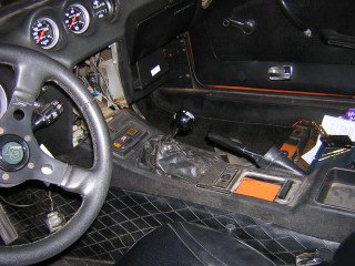

Turbo Meister Posted October 26, 2006 Share Posted October 26, 2006 I'm using a B&M ratchet shifter for my TH400 trans. I cut an opening in the trans tunnel and fabricated a platform about 3" below the top of the tunnel. The shifter was then attached to the platform. There is clearance for the trans and the recessed shifter does not look objectionable. 1 Quote Link to comment Share on other sites More sharing options...

DavyZ Posted October 27, 2006 Share Posted October 27, 2006 I cut an opening in the trans tunnel and fabricated a platform about 3" below the top of the tunnel. The shifter was then attached to the platform. There is clearance for the trans and the recessed shifter does not look objectionable. Turbo Meister, that looks beautiful! Very nicely done. I never liked the look of the whole base sticking on top of the tunnel. Your answer looks fabulous!! Davy Quote Link to comment Share on other sites More sharing options...

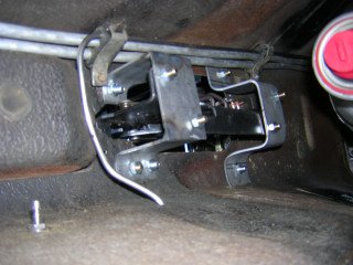

getZ Posted October 28, 2006 Share Posted October 28, 2006 The shifter I used was a Hurst Promatic, but the brackets I used will look similar to the megashifter. The thing to watch out for is how far the shifter goes when it is in park. I was going to use a B+M with a pistol grip but it really goes far forward into the center console. The picture on the right I posted earlier is from underneath without the driveshaft in place. I hate to suggest the dreaded "while you are at it", but it is a good time to upgrade the fuel lines. Also in the pic is the rear brake biasing valve brake lines. Quote Link to comment Share on other sites More sharing options...

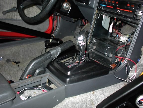

VinhZXT Posted October 30, 2006 Share Posted October 30, 2006 I believe I was the one who asked this question recently. I used the stock C5 auto shifter on my Z. I have not tried to put the stock console back yet so I don't know whether I need to trim the console or not. Here are couple of pictures: Quote Link to comment Share on other sites More sharing options...

Forces Posted November 8, 2006 Author Share Posted November 8, 2006 GetZ, I pretty much copied what you had done. It's a little different, but same idea. The shifter is still a little high for my liking, but you can't win 'em all......sorry about the poor picture quality. Quote Link to comment Share on other sites More sharing options...
