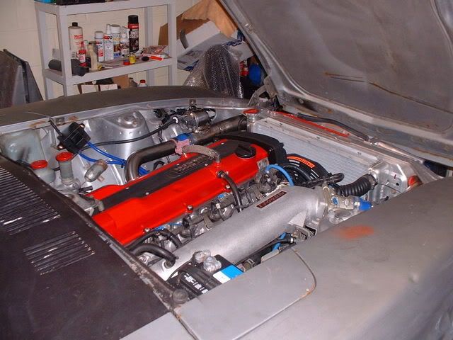

couple of engine shots
Rumnhammer
Just wanted to post a couple of engine shots of the RB in place, disregard the bit of T-shirt on the crankcase vent, it's just temporary as the little K&N filter we are putting on there is back ordered.
The rest of the car is a work in progress (needs to the body shop next) so I'll hold off on overall shots for now. I have to tell people the Han Solo quote. "She may not look like much kid, but she's got it where it counts, and I've made a few special modifications myself, so if you'll just get on board we'll get out of here".;)
