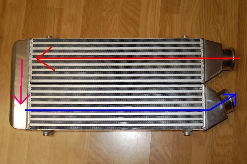

rztmartini Posted November 29, 2006 Share Posted November 29, 2006 this might be a form of dual-intercooling...the air charge passes through the core twice? maybe a stretch. ill tell yall how it works out. Quote Link to comment Share on other sites More sharing options...
dapiper Posted December 4, 2006 Share Posted December 4, 2006 Running cores in series will double the press drop and decrease delta T driving force on second core resulting in less heat transfer although same area. Of the three modes of heat transfer, conduction, convection and radiation, convection is main contributor for intercooling with the air to air films both in and outside the core the major resistances. These can be reduced by increasing flow speed up to a point and increasing temp difference. Increasing air velocity beyond so called turbulent flow or point of diminishing return will only serve to increase press drop. Increasing temp difference will increase heat transfer proportional to the log mean delta T temp diff. These are the physics. Each application is unique, however and depending on air flow and turbo efficiency and where your engine falls on compressor map which affects I/C inlet temp. Also ambient air temp will determine point of diminishing returns. A smaller I/C may prove more beneficial for lower boost on smaller motor. A larger I/C may be better for top end high boost where the inlet temp is greater and the flow velocity increases to raise the Reynolds number to turbulent thereby reducing film coeff resistance. The larger I/C may be inefficient at low boost, however where delta T and flow velocity are lower through the larger flow area. Quote Link to comment Share on other sites More sharing options...
