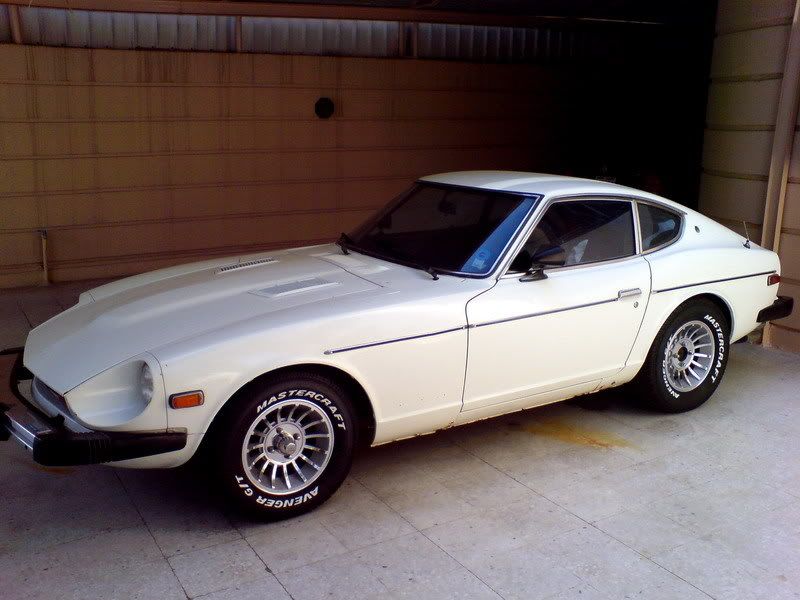

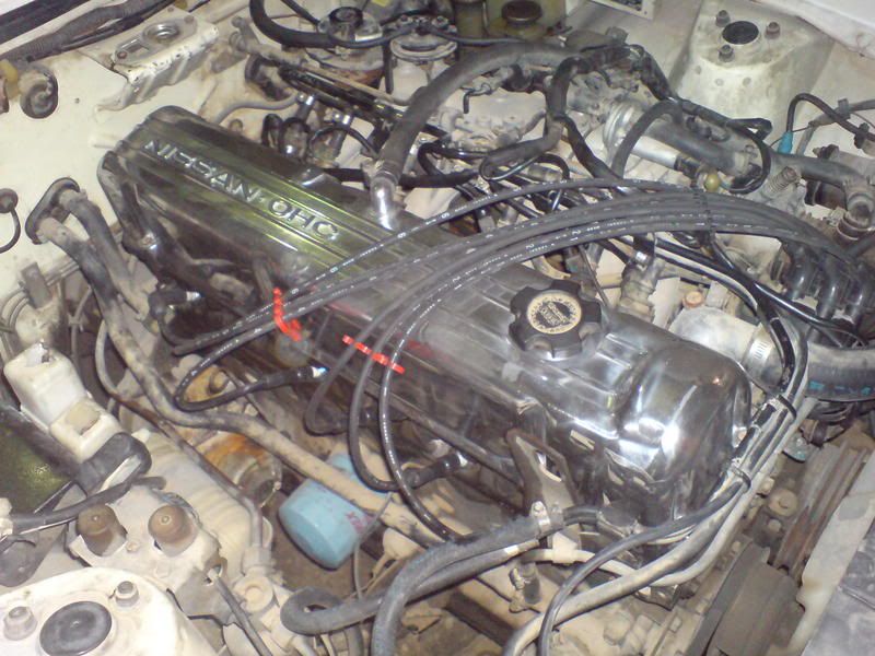

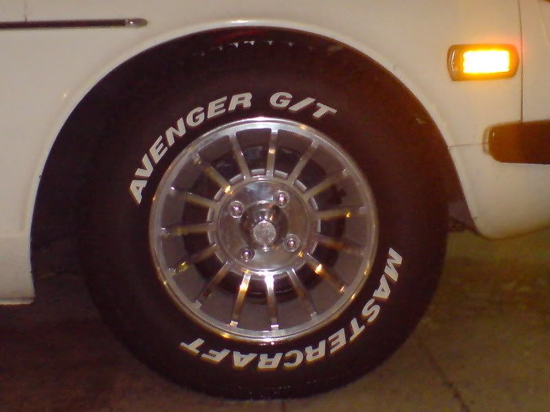

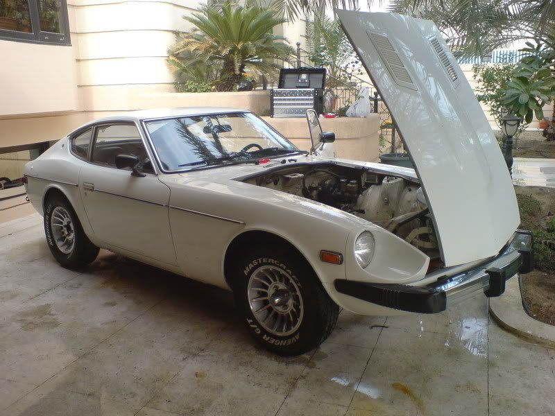

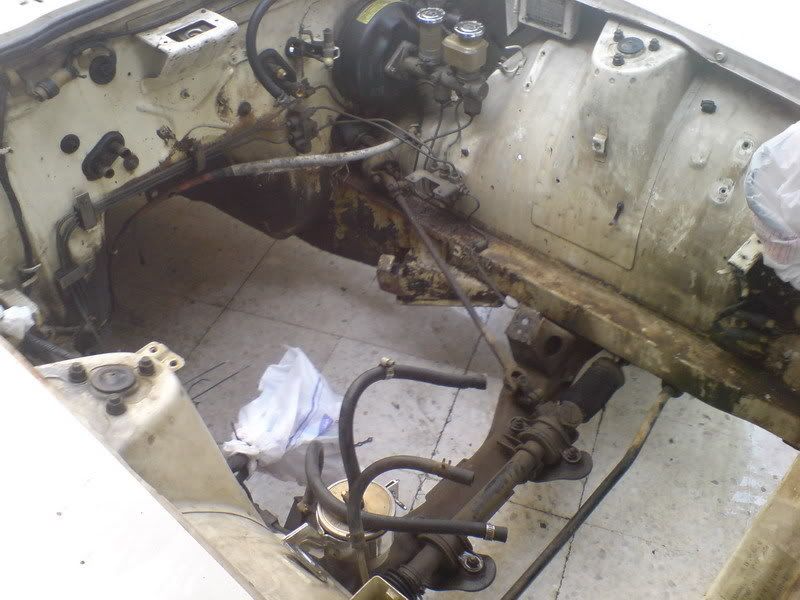

MY77Z Posted December 11, 2006 Author Share Posted December 11, 2006 hi guys, got my photobucket account PHOTOS TIME first day i got the car and the rims looked like hell first thing was paintin and polishin the rims the L28 engine that i dont really like new set of tires day light photo 3 days ago with no engine engine bay, took almost everything out of the bay AND NOOOOOOOOW, THE STICKER 500Z /powered by ford sticker well i had it made today by a local shop, i love this sticker, it's too good to be true, can't wait until i paint my car and stick those on it.... my thread is not worthless now tell me what you think of my ride and MY STICKER Quote Link to comment Share on other sites More sharing options...
Guest QuantumDragon Posted December 11, 2006 Share Posted December 11, 2006 Looks great. You made a huge improvement on everything, especially the rims; they look spotless. On the sticker; I'd probably go a tad more old school on the styling or font or whatever. On the parts side, be sure to leave some money for reinforcing the chassis and upgrading at least the bushings, if not new suspension and brakes for that beast. I have RPMII intake, with AFR185's, X303, rebuilt 302, etc. etc. It fairly roars; it's a blast. I'd ditch the MAF and the factory engine harness and go megasquirt with a fresh, custom engine harness for a pristine look. Old school cars are cool, but old school wiring is not. BTW, if you would be so kind, PM me around what range you were able to acquire that clean Z for? I have a 5.0 right now and seriously considering a hybrid. Thanks, Mark Quote Link to comment Share on other sites More sharing options...
