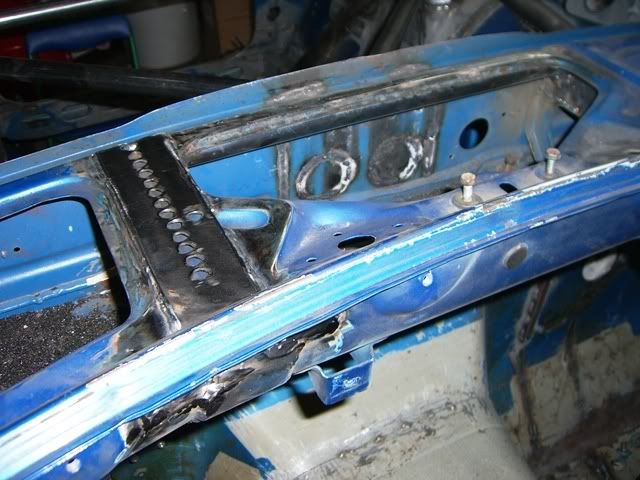

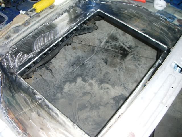

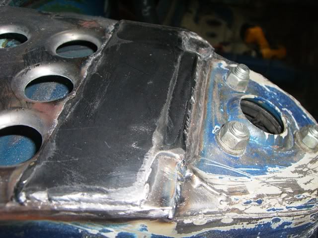

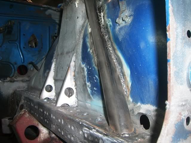

On my 240z i stitch welded the entire car, every seam, under, engine bay, hatch, door seams. frame seams, everything. i had 10mm of play in the line before and now after welding i have less than 1mm, i added a 10pt cage also, but the line doesnt move enuff to create a gap in the sharpy marker line. so it definetly stiffened up the car,
i also added strut bars, and modified the frame rails with thicker metal, and torsion bracing under the cubby boxes.
seam welding took more time than anything else so far... SUPER HARD TO DO!!!!! just cleaning the seams was enough to make you sick of cars for a while... then after you start welding you will end up cleaning them again and again as you keep finding bubbling trash in your weld puddles...
But much stiffer... ohh my.. much stiffer... Your wife will love it...
If you see a seam in these pics that is not welded... It has been welded since I took the pics... I went through a 20lbs spool of wire and 2 tanks of gas... and then a lot of grinding wheels to clean up dirty welds...
