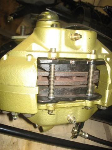

HICKL Posted December 29, 2006 Share Posted December 29, 2006 I am doing the basic swap, S12 calipers, new stock rotors and new ZX master. My question is the little metal clip things that come with the toyota caliper. I can't figure out how they go. Anybody got a pic of one assembled? Thanks Jeff Quote Link to comment Share on other sites More sharing options...
OlderThanMe Posted December 29, 2006 Share Posted December 29, 2006 ah..I had the same problem...lol just play with it for a little while.. The wires go from the outer holes and go under the pad retention bar as far outboard from the rotor as possible. I'll see if I have a pic...If not I'll go take one for you. Quote Link to comment Share on other sites More sharing options...
HICKL Posted December 29, 2006 Author Share Posted December 29, 2006 Mine have 2 wires per caliper and one is primarily straight but the other is all twisted up. Quote Link to comment Share on other sites More sharing options...
HICKL Posted December 29, 2006 Author Share Posted December 29, 2006 I found a pic on line that I think will get it done. Thanks for your help. Quote Link to comment Share on other sites More sharing options...

HizAndHerz Posted December 31, 2006 Share Posted December 31, 2006 I'm installing the Toyota calipers tonight and had the same question about the clips. Found pics at zhome.com: http://zhome.com/ZCMnL/tech/Calipers/brakes1.jpg [url=http://zhome.com/ZCMnL/tech/Calipers/brakes1.jpg][/url] Quote Link to comment Share on other sites More sharing options...

datsunlover Posted January 2, 2007 Share Posted January 2, 2007 The pic of the red caliper is the one I have seen/worked with. My only complaint is getting the two pins out.. although a 4x4 sees a lot more 'crap' than a Z would, so I doubt they'd get gummed up and rusted as much. Are the differing spring/retainers year specific? Or is it just whatever they had at the time of production? (I know there are quite a few listings for EVERYTHIG toyota truck related, sometimes 2 or 3 ieven n one year/model!) Quote Link to comment Share on other sites More sharing options...
HICKL Posted January 2, 2007 Author Share Posted January 2, 2007 the pic with the blue pads is the one I found. Was a snap to install once I had that. Jeff Quote Link to comment Share on other sites More sharing options...
