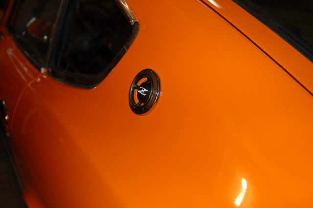

BIGJIM Posted January 15, 2007 Author Share Posted January 15, 2007 The wheels are 17x7's with tociko springs and struts. The spray gun i used is a Kremlin gravity feed. I used just over a gallon. The paint gets a pint of hardener and a a quart of reducer per gallon, so you have almost 1.5 gallons of mixed paint. I didnt mix it all since i knew i wouldnt spray 1.5 gallons of paint. The car has 5 coats of paint on it. My buddy art color sanded and buffed it yesterday and i VERY happy with the results. Its a smooth shiny orange mirror right now Quote Link to comment Share on other sites More sharing options...
BIGJIM Posted January 15, 2007 Author Share Posted January 15, 2007 Here are a couple shots after color sanding and buffing. You just cant get the real picture till you see it outside in the sun. Quote Link to comment Share on other sites More sharing options...

woodboxer Posted January 15, 2007 Share Posted January 15, 2007 what is colour sanding? It certainly brought out the shine. Quote Link to comment Share on other sites More sharing options...
BIGJIM Posted January 15, 2007 Author Share Posted January 15, 2007 what is colour sanding? It certainly brought out the shine. I wet sanded the car with 1500 sand paper, then buffed it with a cutting pad with compound then a polishing pad with polish. Then i washed it and hand waxed. Quote Link to comment Share on other sites More sharing options...

BIGJIM Posted January 16, 2007 Author Share Posted January 16, 2007 so did you have to do that because you used one stage paint. thats all I have done so far. not sure if two stage is easier or just more expensive. I think with clear coat it adds depths and shine, (right or wrong) and what is involved in doing it that way? You color sand and buff with 2 stage as well. Any time you paint a car, if you want that glass smooth finish you color sand and buff it after painting. If i didnt tell you it was single stage you wouldnt know the difference. The depth and shine on this car is as good as any 2 stage ive ever used. Quote Link to comment Share on other sites More sharing options...
woodboxer Posted January 16, 2007 Share Posted January 16, 2007 hey bigjim you are right it looks great, so after i spray with one stage I should color sand? and then buff? if thats what it takes it may be worth it. I am planning on painting my 81 this spring , after I finish the body work, but if I did clearcoat I still have to colour sand? Sorry to be repeditive but I haven't heard of everybody doing that. thanks bob Quote Link to comment Share on other sites More sharing options...
BIGJIM Posted January 17, 2007 Author Share Posted January 17, 2007 Yes, you have to color sand clear. Most dont know this, but when a body shop paints your car they color sand it and buff it before you get it back. If you have a place like macco or one day paint and body paint your car with a single stage, you can color sand and buff it as long as they put 3-4 coats of paint on it. Don't color sand single stage metallic colors. Quote Link to comment Share on other sites More sharing options...
